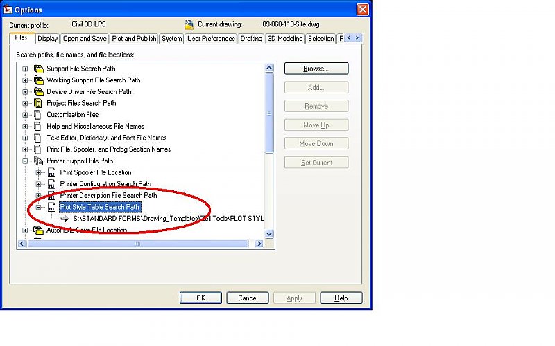

I have been having problems plotting and have found that It is because of incompatible or missing plot styles. I did some research and found out what all this means. My question is this. I have found the acad.ctb file that I need but when I go into options the default plot style table says NONE. How do I set it so that it has the file I need as the default? Im sure it has something to do with the files tab but I am not very familiar with everything in there. I know where the file is but am not sure how to set it. Any help would be greatly appreciated.
I hate to say it but that did not help. It gave me an option to chose which ctb file I wanted in the plot and bublish tab in options, but when I went to print it still told me incompatable or missing plot style even after I told it to use the acad.ctb file. Thanks anyways. If you have any other ideas that would be great
Go to TOOLS > OPTIONS > PLOTTING > Default Plot Style Table
