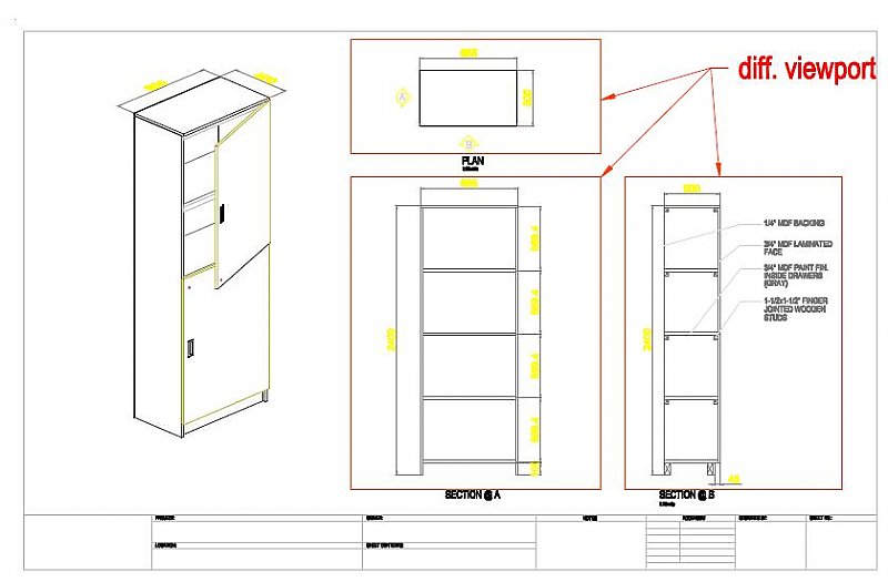

I have attached a file with different Viewports and i dont want the viewport edge/line to be visible in the plotted file.Is there a way to hide only the viewport edge?
You can put the viewport on a separate layer, make it a "no plot" layer. Some people use "defpoints" layer for that, but that's not as flexible.
The best way to do it is create a layer you can name it viewport then when creating viewport in paper space use this layer, when your ready to plot the drawing simply turn off the layer viewport.:D
If you do this, you will always have to remember to turn off the layer before you print. Just do as Carl suggested and set the layer's plotting option in your Layer Manager to No Plot. Then you won't have to waste paper every time you forget to turn the layer off.
Thanks you for the replies guys, i have used carl's suggestion and i got what i wanted.
