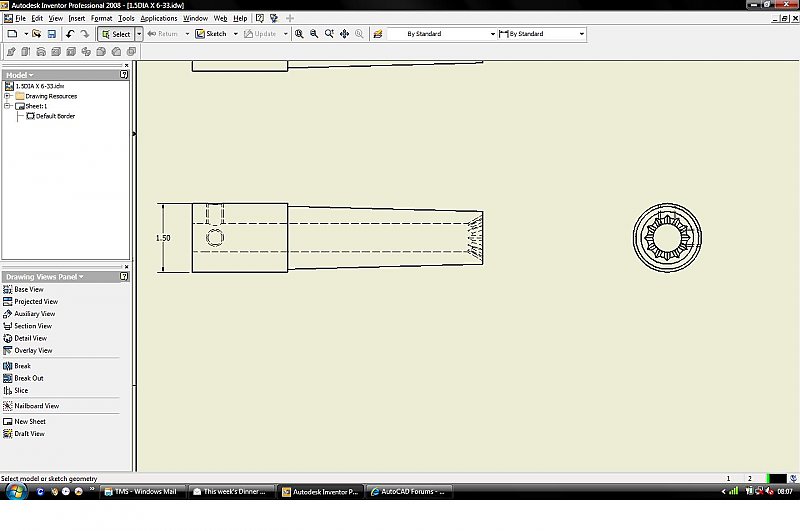

When adding a dimension for a diameter on a side view, the sign is missing.Is there a setting that can automatically add the diameter sign?
Is that a retrieved dimension or a placed dimension?
Your extension lines do not look correct - no gap on top extension line?
What happens if you click ONLY on that leftmost vertical line and then click to place the dimension?
How much training have you had?
How much of that training concentrated on creating 2D drawings.
The Ø should be automatic when done correctly.
