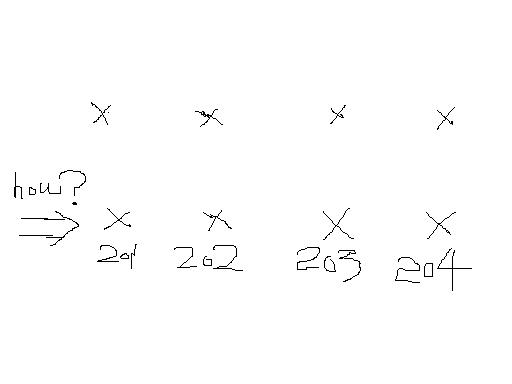

there are four points,
I want to label them with 201,202,203,204(the start number can be define by the user )
when I click the first point ,it label with 201
when I click the second point ,it labels with 202
when I click the third point ,it labels with 203
when I click the forth point ,it labels wit 204
how????how ?
please look the attachment.
who can provide me with a LISP file which can achieve my purpose ?
there are many many points which I want to label .so I need to find a quick method to label them in sequence ,I think there should be a clever man who can helps me ,my native language is not English ,if you cannot understand my expression ,please contact me

OK!thanks a lot !it's very kind of you ,because my native language is not English ,so I do not know how to search my interest topic in this forum with English keywords exactly ,so I upload a picture in order to make the people who browsers my thread can understand my expression exactly .
