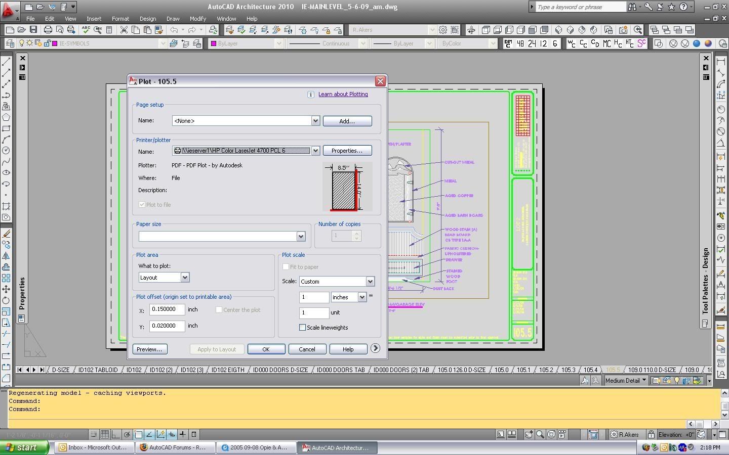

mrbucket Posted December 18, 2009 Posted December 18, 2009 Hey all. First issue I have encountered in awhile. We use PDF transmission of drawings of various sizes. During PDF making of legal size (8x14), I made it about 75% through 15 sheets and all of a sudden Acad wouldnt let me make PDF's in legal, and on top of that, it defaults to the printer and produces error ridden pdf into file folder that I started with. I use Adobe Acrobat Pro to combine these after production. I did recovery on it and still the same, I tried different drawings and same thing. However.......Any other size no problem. Any ideas? Did I accidentaly click something Im missing? Thanks in advance! Quote

mrbucket Posted December 21, 2009 Author Posted December 21, 2009 Sounds like an AutoCAD bug for sure. Can you assign a custom page size to 8.5 x 14 and avoid the built in legal page size? Yes, I did try that. I set the page size for layout and then again set it as default, dwg to pdf.....it asks me for default or custom size (like it always has).......click custom that says 8.5x14.00...then goes back to that menu with no page size set, but it gives preview of size picked on the right. Quote
rkent Posted December 21, 2009 Posted December 21, 2009 I see in the image you posted that you are trying to use the PDF driver supplied by Autodesk. I thought you were using the Adobe Pro driver. When I use Adobe Pro it shows Plotter: Adobe PDF Converter - Windows System Driver - by A.... So, are you trying to use Adobe Pro or the Autodesk driver? Quote
mrbucket Posted December 21, 2009 Author Posted December 21, 2009 I see in the image you posted that you are trying to use the PDF driver supplied by Autodesk. I thought you were using the Adobe Pro driver. When I use Adobe Pro it shows Plotter: Adobe PDF Converter - Windows System Driver - by A....So, are you trying to use Adobe Pro or the Autodesk driver? It has always used that, and honestly, I dont recall it being different. Did you do something that makes it default to the pro? Quote
mrbucket Posted December 21, 2009 Author Posted December 21, 2009 update..... Ok, I just saw that it gives 2 options for pdf in my plotter menu now. I have never had any issues with the dwg to pdf.pc3 setting until now. What is the difference between the AdobePDF one and that? Quote
