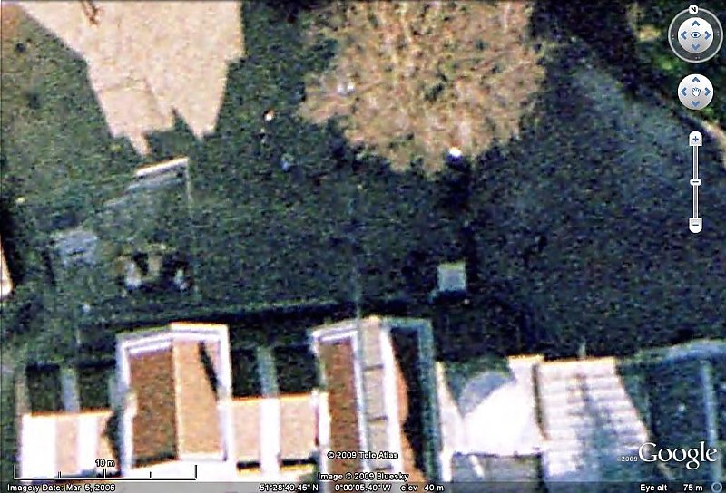

eldon Posted December 22, 2009 Posted December 22, 2009 I check surveys by importing the Google image, but I do it in a very simple way. In Google Earth, click View, then Scale Legend. Then I just save the Image and there is a ready made scaling bar included. Just check the date of the image, because further construction may have taken place. This image is at Greenwich on the Prime Meridian, and shows that Google Earth coordinates are not zero at the zero Meridian. Quote
