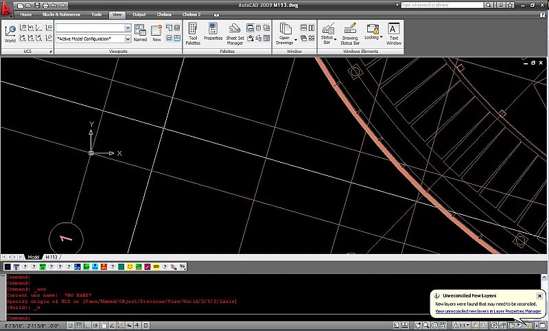

chelsea1307 Posted December 22, 2009 Posted December 22, 2009 Usually clicking world for the view will bring the crosshairs back to normal (aligned with the usc) right now Y is straight up and X is to the right but my cross hairs are at an angle. I attached a pic to clairfy. How do i get my cross hairs to align Quote

eldon Posted December 22, 2009 Posted December 22, 2009 If you go into the units setting, the base angle has been set to 106 degrees. If you set that back to one of the more normal directions i.e. East, then set SNAPANG to 0, and there you are. Quote
chulse Posted December 22, 2009 Posted December 22, 2009 If you go into the units setting, the base angle has been set to 106 degrees. If you set that back to one of the more normal directions i.e. East, then set SNAPANG to 0, and there you are. Ahhh! I never thought to check the base angle (since the SNAPANG was already 0) Excellent. Quote
rkent Posted December 22, 2009 Posted December 22, 2009 ANGBASE set to 0, then SNAPANG set to 0. Quote
chelsea1307 Posted December 22, 2009 Author Posted December 22, 2009 thanks eldon and rkent both solutions worked! Quote
