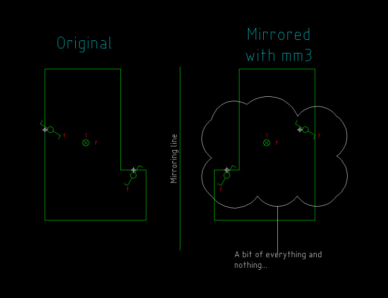

Hello again,
I had to try!
Lee, this is what happened after selecting 4 blocks:
Command: mm3
Select objects: 1 found
Select objects: 1 found, 2 total
Select objects: 1 found, 3 total
Select objects: 1 found, 4 total
Select objects:
Select First Point:
Select Second Point: ; error: too few arguments
So that does not seem to work... Maybe I can fix it myself but if there is one thing I have learned lately is that I am a bit of a rookie.

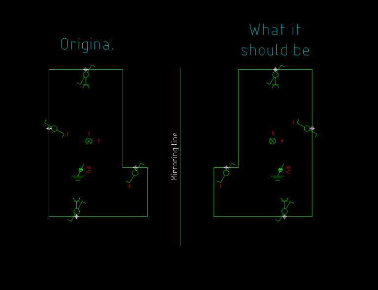

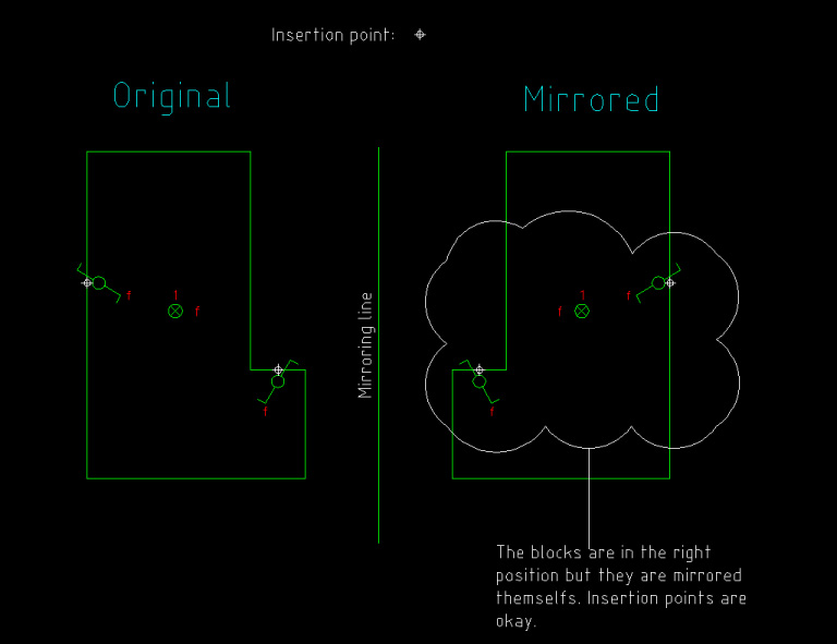

I can imagine why anyone would ask what purpose I have for such routine. As Lee said:
I thought the idea was the get the positional effect of mirroring, but without the visual difference (copying, as you say - which is what one part of my code above is doing).
Yes that is what I want to do.
In my daily work we install plumbing / electrics etc. Mostly in houses.
In most projects there are several types of houses, like a small one, big one, one in the middle, house on the corner. And the mirrored ones. If I mirror the blocks from the normal house to the mirrored one then all my block are mirrored themselfs. To follow standards like NEN / ISO etc. one must mirror them back.
Therefore I need it.

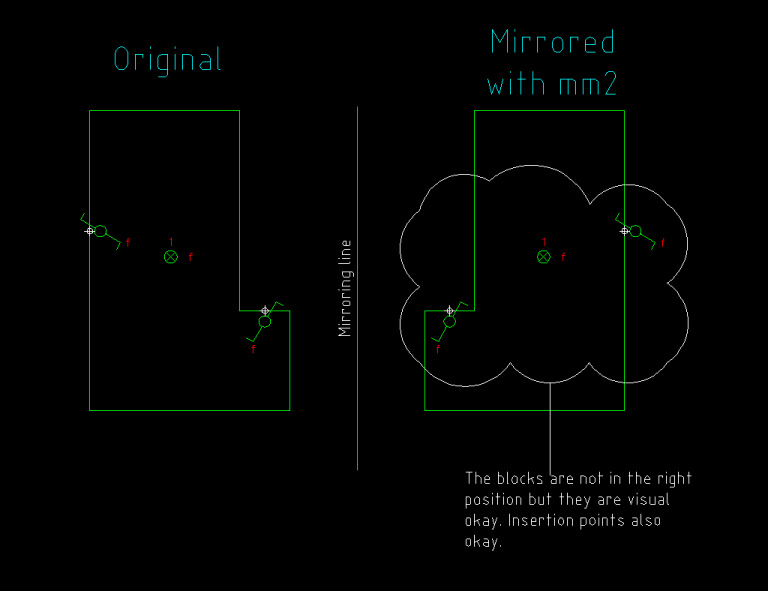

Lee, see these images, can you follow me?
I mean, the code is great but not 100%.

Yeah, that was my approach in MM2 here
Didn't see your code - it only logically
~'J'~

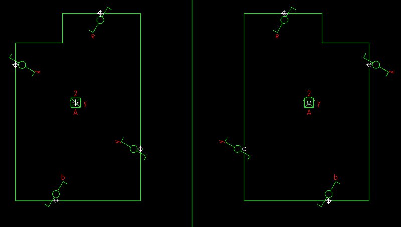

Hi guys,
I have tested all codes but there is one problem.
From the code Fixo supplied: I like the way it works.
Selecting the mirror line first and then the blocks.
THen it mirrors like it should but not all off them.
See image.
Please fix-o. :wink:
Could themirror line be a xref too?
What about text? It does not do that, is that possible?
WIll buy nw keybord first.
(Those white thinngies are the insertion points)
