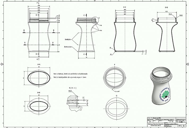

I'm trying to complete a school assignment, it's a deodorant bottle.
As the shape is rather complex I'm trying a loft with 4 sketches and two rails. Without the rail the loft works well, but with the rails i get a error message "rail curve is not smooth".
I have attached a zip with the drawing and my part file. (I saw now that one of the rail curves was incorrect, but it was still error after I made it like the drawing)

Several of your sketches are not fully constrained. Your rails must be tangent continuous - no sharp corner changes.
How should I make the rails smoother and still have the measurements as in the drawing?
I guess that when a sketch turns blacks it's constrained but I can't get the ellipse black. They are measured and on the z axis.
