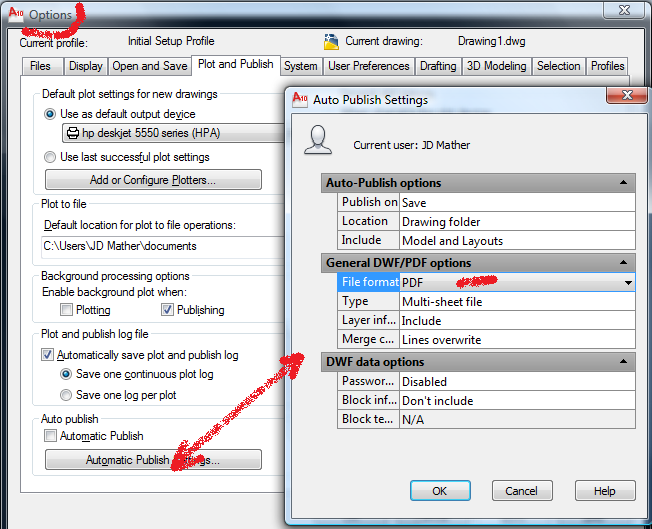

muck Posted December 29, 2009 Posted December 29, 2009 Does AutoCAD 10 have a feature that will save or plot a pdf when a file is saved or plotted? If so, how do you use it? Thank you, Quote
JD Mather Posted December 29, 2009 Posted December 29, 2009 when a file is saved or plotted? Not sure I understand the question. I don't think you would want a pdf created everytime you save a file (for me that would be about every 5 minutes). Are you simply asking how to create a pdf file? Or are you asking how to simultaneously create a plot and pdf file? Auto Save or Make a pdf with AutoCAD 10? Are you using v10 or v2010? v2010 has a built in driver. Quote

muck Posted December 30, 2009 Author Posted December 30, 2009 Here is another thing I have been wordering about. AutoCAD has a AutoPublish command which makes a file but it is not a pdf. What is the purpose of that? Thank you, Quote
ReMark Posted December 30, 2009 Posted December 30, 2009 AUTOPUBLISH "Publishes drawings to DWF, DWFx, or PDF files automatically to a specified location." Quote
muck Posted December 30, 2009 Author Posted December 30, 2009 So you can get the Autopublish command to publish pdf files?. All I could do is to get it to make Dwfx files. How do you use it for pdf files? I don't see where Autopublish prompts the user for pdf files? Thank you Quote
JD Mather Posted December 30, 2009 Posted December 30, 2009 F1 search on autopublish, I let you do the reading. Quote
mrbucket Posted December 30, 2009 Posted December 30, 2009 F1 search on autopublish, I let you do the reading. This needs to be more specific. Good Find, I no doubt will use this at some point. My issue is the amount of work that may be done in between saves. Saving frequently to have a build-up of files would not work for me then. Quote
JD Mather Posted December 30, 2009 Posted December 30, 2009 I had never used this before, so I did a bit of reading of the Help files myself. Quote
JD Mather Posted December 30, 2009 Posted December 30, 2009 Saving frequently to have a build-up of files would not work for me then. I don't know, looks to me like it will simply save two files rather than one keeping both the pdf and dwg up-to-date. Quote
mrbucket Posted December 30, 2009 Posted December 30, 2009 I don't know, looks to me like it will simply save two files rather than one keeping both the pdf and dwg up-to-date. After looking at it again (the pic you posted), it looks like (of course I should just try this) that it will pdf all tabs and model space? Quote
