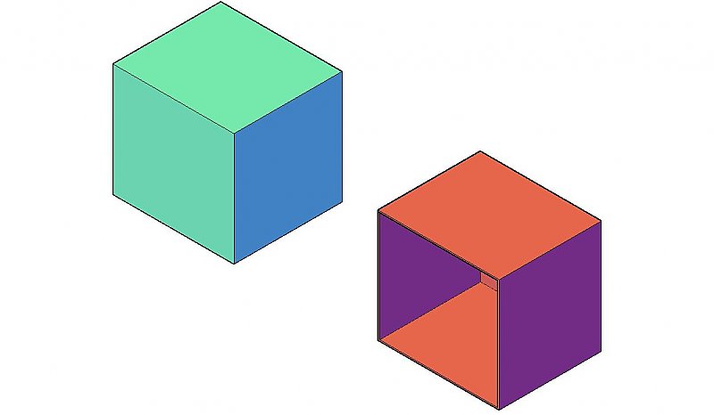

ReMark Posted December 29, 2009 Posted December 29, 2009 Here's proof. Pale green box is before using Slice command; red box is after. The surface I used to slice the box front was erased after use. It (the surface) was just a simple extruded line. Quote

kencaz Posted December 29, 2009 Posted December 29, 2009 Here's proof. Pale green box is before using Slice command; red box is after. The surface I used to slice the box front was erased after use. It (the surface) was just a simple extruded line. [ATTACH]16513[/ATTACH] Did you leave out something ReMark? It looks as if your red boxed has been shelled? I believe that is what the OP was referring when he tried to slice the solid and it only resulted in an additional surface. I think "Shell" is needed for a solid box... KC Quote
ReMark Posted December 29, 2009 Posted December 29, 2009 I assumed, perhaps incorrectly, that since the OP said "box" as opposed to cube he had already discovered the joy of "Shell". Quote

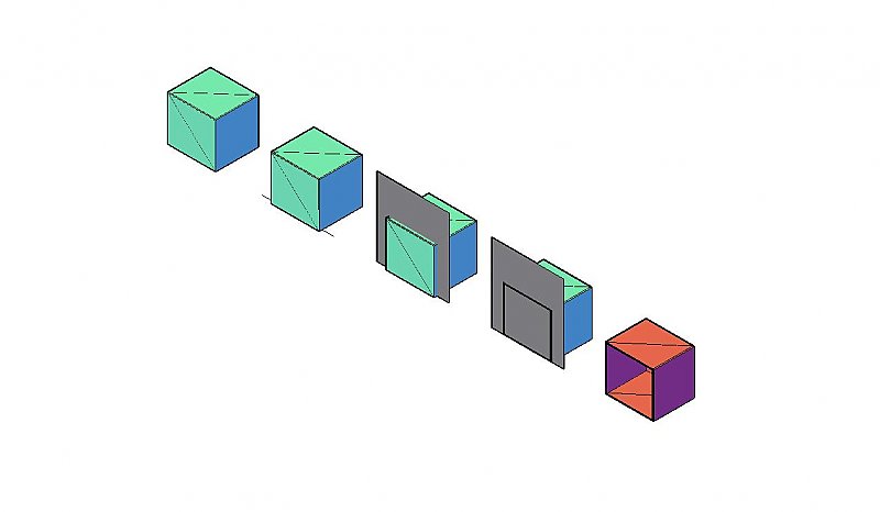

ReMark Posted December 29, 2009 Posted December 29, 2009 From left to right. My "shelled" box. No interior visible. Box with simple line. Box with line extruded to form a surface. Slice command used with the "Surface" option. Retained back of box by letting AutoCAD remove the front for me. End result (in red). Questions? Quote

ReMark Posted December 29, 2009 Posted December 29, 2009 It looks like shell to me on that image, but Remark would mention it if it was the case. I tried Surface, but all it renders is an additional face where the plane sat. No luck with open-end geometry. Then I obviously don't know what it is you're looking to do for which I apologize for wasting your time. Yes, as mentioned, I did "shell" my box to create a true box (or container) prior to carrying out any other commands. Quote
