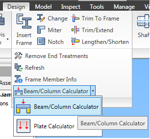

AIS does not have FEA. There is limited Beam & Column Calculator in the Frame Generator. (check the drop down in Ribbon - took me a while to relocate this in the new interface)
Must have Inventor Analysis or Inventor Professional for more complete FEA.
