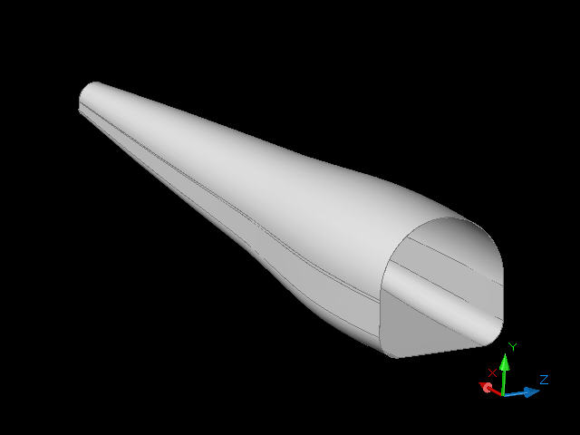

cuwaert Posted January 3, 2010 Posted January 3, 2010 Hi, I had the audacity to start modelling a modell airplane using Autocad 2008. I know autocad isn't the wright application to model reasonable complex shapes as airplanes but because of some familiarisation with it I took the challenge. I carved the first halve of he fuselage using slicing a rectangular solid. I tried to fillet the edges but I get all kinds of error messages I don't find in the manual. this one for instance Modeling Operation Error: Spring curves do not intersect. Failed to perform blend. Don't know what a spring curve is or what the problem is. I'ts also very tedious to select all edges of the many meshes, is there no way to just select the complete edge of a solid? Quote
Coosbaylumber Posted January 3, 2010 Posted January 3, 2010 Could be due to accuracy. But if it "Looks" like it should go where shown, and you intended to make it go there then OK. But, usually that sort of error message is because the endpoints to not (now) touch one another properly. Grab on to the end point of one line and move it over to the other point. Your UNITS or settings may say same point, but way down in the accuracy bin at like 1/10,000 or 1/100,000 setting they may not be. Or can be due to some Z factor. But simply try and move it even it they look and measure the same. Wm. Quote
cuwaert Posted January 3, 2010 Author Posted January 3, 2010 or this one Modeling Operation Error: Cannot find mitre details where open sheet ends meet. Failed to perform blend. Failure while filleting. Allso on filleting. Cannot find the message so don't know what's happening. Error messages are essential, where can I find them and their explanation Quote

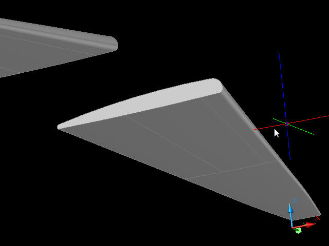

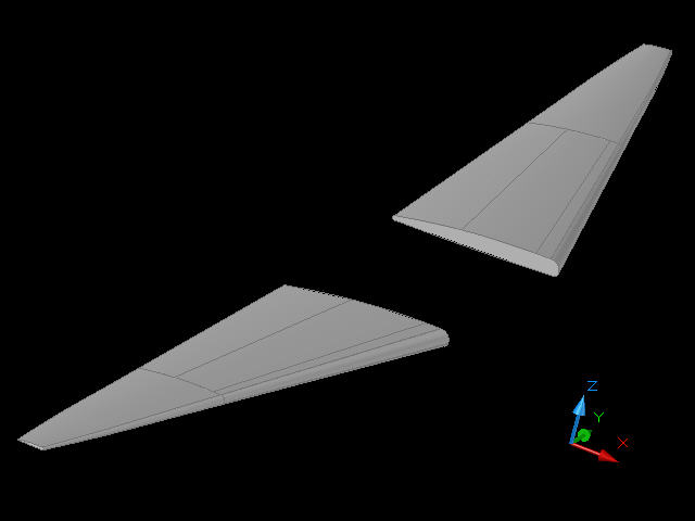

kencaz Posted January 3, 2010 Posted January 3, 2010 You might try lofting your profiles, (or ribs). This can give some pretty good results. Here is a lofted wing section: KC Quote

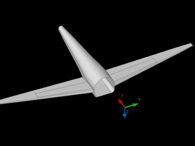

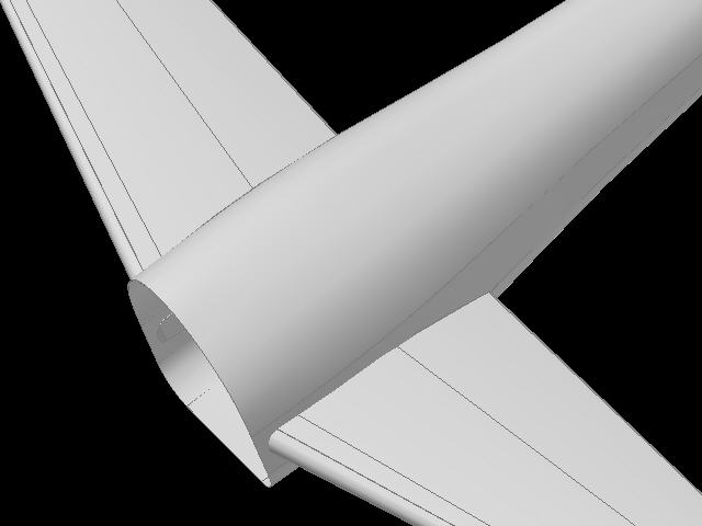

kencaz Posted January 4, 2010 Posted January 4, 2010 Add a fuselage: Put them together: I think AutoCad is a great tool to model your scale aircraft with... KC Quote
