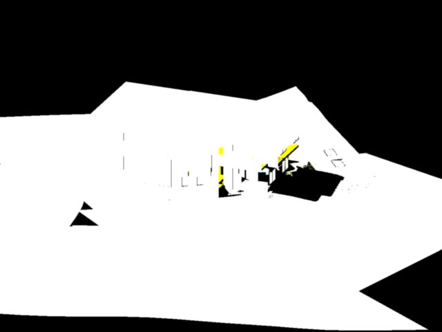

I am using AutoCad 2010 to create a 3D model of a villa for my arch project and I had everything finished. All my house elements are solids with materials textures (from a library for 3DSMax), used some doors and windows from ACad Arch 2010, made a terraing of meshes. I tried to render it with default lighting, received this: render2.jpg
Then I tried using sun status for my location - Sofia, Bulgaria for midday hour and got this: render.jpg
The solids, all materials are transperant!? Even though I have made them all with Opacity 100...
See this only for proof that the house actually looks nice :D default lighting image.jpg
To be honest this is my first real project Autocad 2010 render... so far I worked with archicad, which had positive and negative sides... Does anyone have a stunningly simple idea as to why I cannot make a simple rendered image? :)

Well, it appears that all of your materials have Reflection turned all the way up. Open your Materials Manager and turn down the Reflections and you should get a much better render.
In the materials menu i changed the following on the materials:
shininess - 0
reflectance,
transmittance scale - 0
Using the sun status with intensity factor 20 (it appers to light up the house nicely), also tried with a low number (0,01) still nothing different happens - everything is glazing white?!
I read before the FAQ, tried to modify the global material the same way, nothing...
I now know for sure that I have screwed something very bad... Just need to know where to look :)
