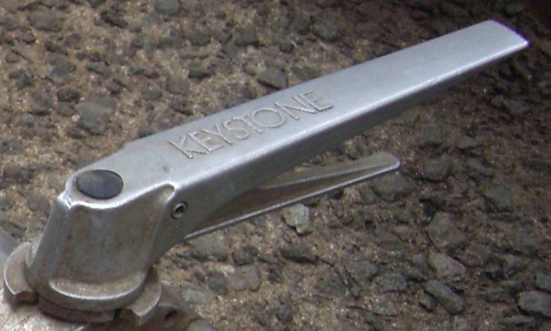

Hi
What commands would i use to construct this handle.The sloping round section i am not sure on which way to construct.

I will get a hold of a handle which should give me a better look at how to construct the model.When sketching would i form the round section first and extrude followed by next forming the handle again with a extrude?
I think the slanted angle of the round section will be the difficult section for me to try and create.Very much a beginner at the moment with Inventor 2010

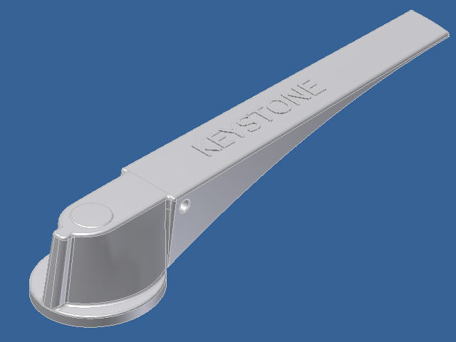

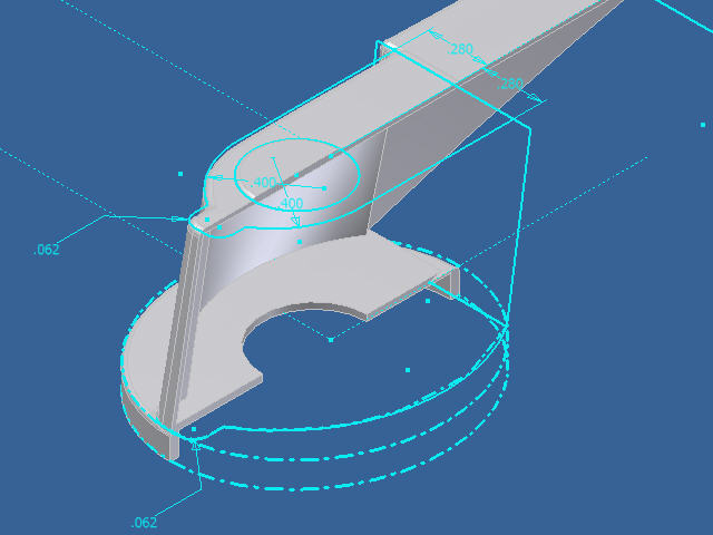

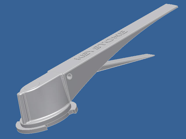

I used a couple of offset lofted profiles to do the main body.
Extruded an ellipse for the base attempting to match the contours of the lofted section.
Then lofted the handle using 3 offset rectangular profiles... You can use more if you want a smoother loft.
Then you can use Shell to hollow out the solids and add your holes and text.
KC

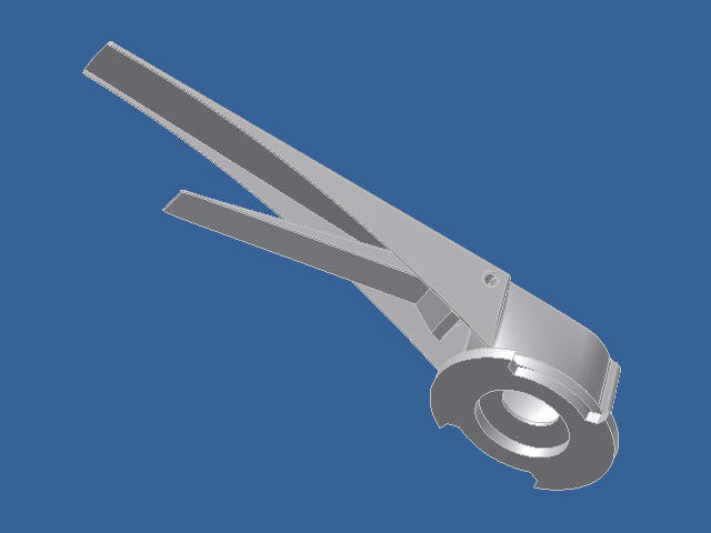

And with the additional lever added...
