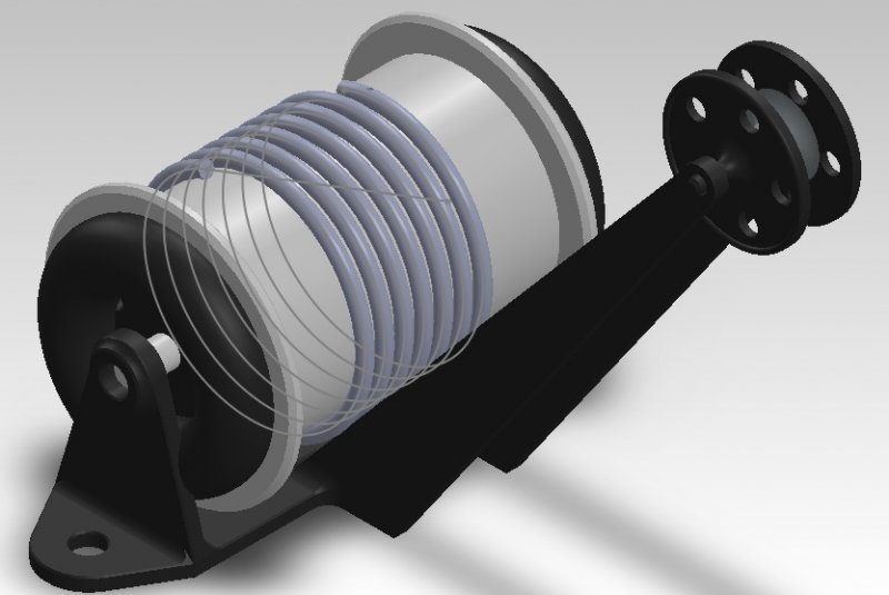

swarup007 Posted March 5, 2012 Posted March 5, 2012 thanx for replay. i want to make a rope which will come out from the rope drum through different pullies and it will lift up an object. waiting for ur replay. Quote
JD Mather Posted March 6, 2012 Posted March 6, 2012 The solution to the original question is to drive or animate a parameter. Attach your assembly here ..... Quote
swarup007 Posted March 8, 2012 Posted March 8, 2012 please give the solution for this. i have to bring out the rope over the pulley. Quote
