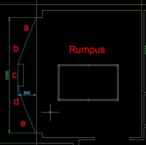

i am current drafting a Residential Home, that has a complicated window configuration, that needs to fit into a 5000mm Cavity in the Rumpus room.
(Please see attached image)
Requirements of the geometry:
  1. The center window panel © needs to be 800mm from the external wall
  2. All window Panels need to be equal in length. (the same size)
  3. Window Panels (a),(b),©,(d),(e) are variables
  4. Window fitting must have 5 panels with 6 angles
How can i determine the correct angles and window panels size to fit the 5000mm Cavity in the Rumpus room?
Any suggestion would be appreciated.
(Please see image to see what I'm getting at)
I don't know if this is the 'right' way or even the easiest way but I would use the 3 point circle command and the offset command.
You have 3 fixed points in your drawing. The two points on the exterior wall at the edge of the 5000mm cavity and the center point of the window 800mm left of that. Draw a circle on those three points. Offset the circle (inwards) the thickness of the wall/windows. Now draw 2 rays from the center of the (concentric) circles to the exterior wall corner points. Measure this angle and divide it up into 5 window bays.

whups, sorry, that's really close but not right. I think that working with the midpoint of the wall edge and the midpoint (both x and y) of the window will give you what you need.

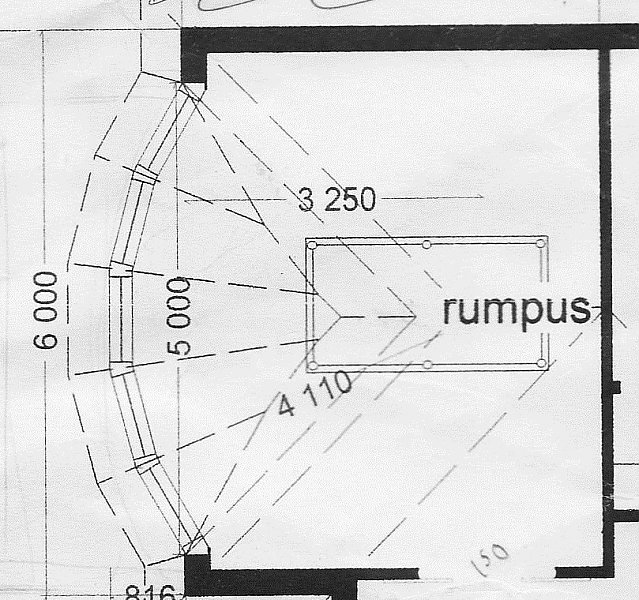

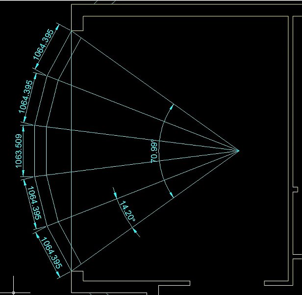

thanks for help Geobuilder and Glen.
Using the current method i noticed i can't get all window panels the same length. However, for practical purpose I'm sure this solution will be fine.
(see bellow for current results)
In terms of geometry is it at all possible to get exact equal sized windows?
Look as I did

I was curious about a mathematical solution for this but found the equations got sticky pretty fast.
I took what I could to Excel – as an opportunity to give the Solver feature a try.
This spreadsheet (requires the Solver Addin) will calculate the necessary dimension for a 5 facet Bow Window of any depth or width. Input the desired depth (800 in the case of the OP), then go to Tools – Solver to input the desired width into the “Value of:” field.

Geobuilder,
you have been very helpful, however don't understand what your doing with ploy line when type (*0.8(/0.80.7670):oops:
As Geobuilder seems to be master of the visual, perhaps I could explain in words what I think is going on.
The first arc was drawn so that the offset to the centre was the required 800. When this arc was divided into 5, and the chords were drawn, the offset to the chord was 0.7670, which is not what was required.
What then happened was that the 0.8 length was scaled up by the ratio of 0.8 divided by 0.767 which was calculated on the screen with a lisp expression (/ 0.8 0.767), which gives a factor of 1.043, and the arc was then stretched to this new offset.
I apologise if I have got it wrong, but that was the way that I saw it.
Graphically, there is no exact solution, but successive iteration gets near enough. :D
What for
When I approximated an arch distant from 800, We have received a line distant from 767. Having divided 800 on 767 (/0.8 0.767) I have learnt How long reduce distant 1.04302, have then increased received on necessary for us 800 (* 0.8 1.04302), has received 0.83442.
Thus if we approximate an arch distant from 834.42 we will receive a line distant from 800. Certainly it not is the mathematical formula, and true result we have received only because distance a little, and at bigger distance such focus will not be possible.
Mathematics you can find in a file attached by SEANT.
