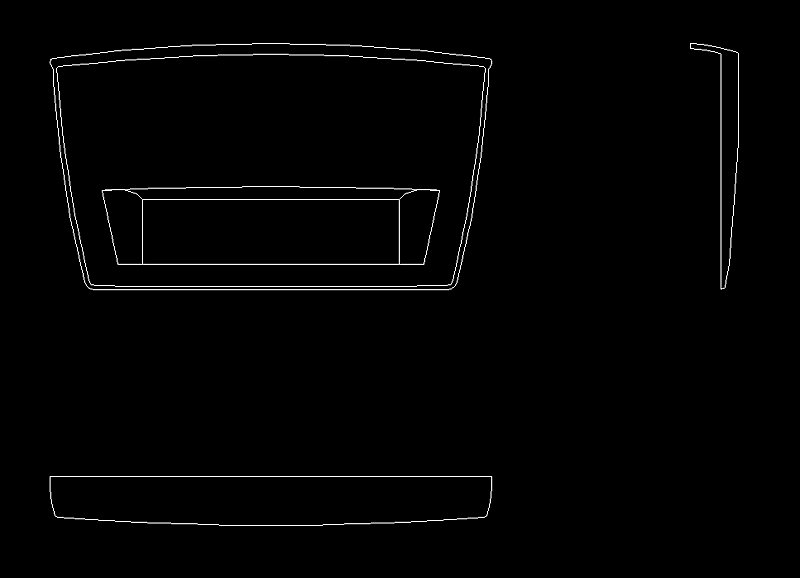

How would I go about drawing the attached drawing in 3d?
I'm fairly new to the 3d experience but have managed to pick up most of the simple 3d operations but the curved nature of what i'm trying to draw has me stuck.
Any assistance would be appreciated. (Step by step instuctions would be great)
It appears you already have the profiles so one method would be to extrude them.
I've seen a tutorial that basically said that a person could create a top, front, and side view of an object, extrude all three, and then use the Intersect command to obtain the final shape. The example used was of a guitar. Maybe it would work here too?
Thanks ReMark.. I have done as you said and it works exactly as i had as I needed.
