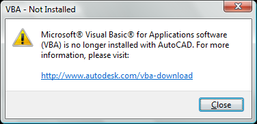

rkmcswain Posted January 15, 2010 Posted January 15, 2010 A lisp code to work on all viewports? I don't know what you mean, as I said my problem is with the layout papersizeMy bad. I meant layouts. VBA dead? I don't think so, otherwise this forum would not mention it. From a support standpoint, yes you can still run VBA code in AutoCAD, but Microsoft killed it off back in 2007, so there is no reason to start writing VBA code today for a new project. Layouts are Viewports in LISP VBA is definitely dead - or heading that way, 2010 no longer has it as standard and as RKMcSwain says, 64-bit has performance problems. Quote

JonathanP Posted January 20, 2010 Author Posted January 20, 2010 Again, I work both with autocad 2010 and 64-bit, no problems so far with VBA. I must confess I am a bit confused, you guys say VBA is dead but when I look for VBA tips I can always (or most of the times) find them here... Perhaps VBA might be dead indeed but there are still plenty of people out there who still use it. I personally don't mind changes or learning new programs, but as my work requires more engineering than drawing, I am struggling to find enough time to keep up with Autocad new programming tools. Anyway, I have not yet found any application which would allow me to use userforms (or windows), except for VBA. If you know any way, please let me know, I would certainly like to learn about it. Thank you Lee Mac for the lisp code, though what I am trying to work out is a bit more complexed, as I have layouts printing on different printers to match the format. So I would like my program to find first the layouts printing on the old device and then change only those ones amongst the many others printing on different printers. Quote
Lee Mac Posted January 20, 2010 Posted January 20, 2010 You can create dialogs with DCL to run with LISP, and many other languages also support dialog creation. VBA is getting phased out of AutoCAD, as Microsoft is no longer supporting it but yes, there are those that still use it. Quote
rkmcswain Posted January 20, 2010 Posted January 20, 2010 I must confess I am a bit confused, you guys say VBA is dead but when I look for VBA tips I can always (or most of the times) find them here... I'm not sure why that is confusing. VBA has been used with AutoCAD for the last decade, so of course there will be tips here and other places, but that has nothing to do with the current state or future of this technology. Perhaps VBA might be dead indeed but there are still plenty of people out there who still use it.Certainly, and people will probably keep using it for many more years, as long as you are using a version of AutoCAD that supports it, there is no problem. But expect many other users to move on over the years, which means less and less support out there in the world. My guess is that this spring, or maybe next spring (AutoCAD 2011 or 2012), VBA will be removed entirely from AutoCAD. The program(s) you are using must not be very large if you can't see a speed difference when running them in 64-bit. My testing (along with others) shows it's about 10X slower which makes sense, since the code is being run though a emulator since there is no direct support for VBA in 64-bit systems. Anyway, I have not yet found any application which would allow me to use userforms (or windows), except for VBA. If you know any way, please let me know, I would certainly like to learn about it. I can't think of any language that does not support dialogs. Lisp, .NET, C++/ARx all support dialogs. Quote
