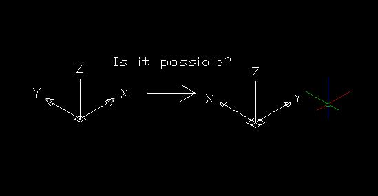

ongx2 Posted August 14, 2008 Author Posted August 14, 2008 Here is an image i made, is it possible to adjust UCS into that way? The X and Y are both 0 degree and 90 degree. Quote

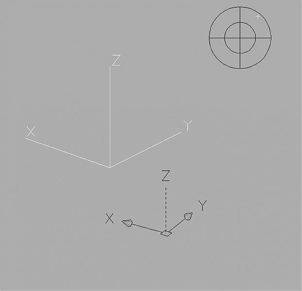

eldon Posted August 14, 2008 Posted August 14, 2008 I know nothing about 3D viewing, but I had a little play with View, 3Dviews, Viewpoint and this appeared. I think the Z axis is dotted because you are viewing from underneath. Quote
Hoozin Posted August 15, 2008 Posted August 15, 2008 Here is an image i made, is it possible to adjust UCS into that way? The X and Y are both 0 degree and 90 degree. What you are describing is a Left-Hand coordinate system. The default in ACAD is right-handed and I don't know of any way to change that. Interestingly though, typing "left hand" into the ACAD help file returns the UCS as the highest hit. Quote

Hoozin Posted August 20, 2008 Posted August 20, 2008 you can change also the position of the z axis using the ucs command, turning it to position upward. . . Doing so (when I tried it just now) flips the X and Y axes. I really don't think you can make AutoCAD give you a LH Coordinate System. Possibly with a lisp, but I wouldn't count on it. Quote
ongx2 Posted August 25, 2008 Author Posted August 25, 2008 Yea siatong I have tried your idea and it seem doesnt work lol. Maybe I have to re-explain my question. In some cases, when I export Cad drawing to other application, all my X coordinates will be swapped with Y coordinates, results in appearing a different drawing. Therefore, I need to swap all my X coordinates with Y coordinates in Autocad again and export my drawing to other application.. Is there a common method to overcome this type of problem? That is how my boss describe the problem to me :/ He ask me to learn how to overcome it before I face this problem lol. Quote
Hoozin Posted August 25, 2008 Posted August 25, 2008 Now ... there MIGHT be a lisp or VBA out there that can do that actually (switching X coords with Y coords for every point), but I neither know how to write it (working on that though) or know if there's one already in existence. My question is, why do you have a program that works in a LH Coordinate system? It may be easier to go into that program and see if you can change the UCS in it. Quote

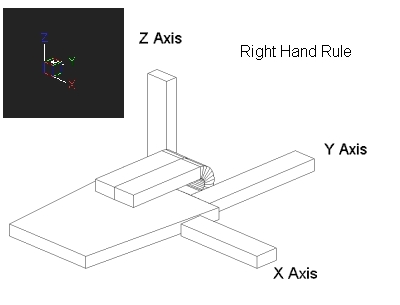

David Bethel Posted August 26, 2008 Posted August 26, 2008 Hoozin is correct, AutocAD is right hand UCS . There isn't a work around for construction in AutoCAD but you can rotate an INSERT or DFXIN. A lot of true 3D apps are left hand, a few are right hand ( Vue ). It can make for a difficult transition in thinking. Extruding in LH apps changes the Y axis not the Z. I personally didn't adapt well, so I stuck with acad. -David Quote

ongx2 Posted August 27, 2008 Author Posted August 27, 2008 I see...Cool David on the pic u made, it make me understand more on right hand rule lol Thanks all of you for the concern, have a nice day Quote
