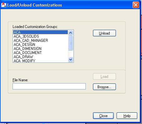

zionshea Posted January 16, 2010 Posted January 16, 2010 Hi all, Please see attached file and help in the following: 1. How do I bring back the menu items? 2. How do I bring bcack the ribbon tabs or pannels? 3. How do I put the command line to its old place, to the lower part ofthe screen? Thanks. Quote

zionshea Posted January 17, 2010 Author Posted January 17, 2010 Thanks all for your prompt answer. 1. Menubar=1, this helped - thanks. 2. CUIload, not sure what should do with this popup menu to remove the the message "The ribbon does not have any tabs or pannels currently loaded" and bring back the tabs and pannels. 3. Command line: The and the worked fine - thanks. Quote

ReMark Posted January 17, 2010 Posted January 17, 2010 What appears onscreen when you type CUIload? Quote
zionshea Posted January 21, 2010 Author Posted January 21, 2010 I managed to fix this "The ribbon does not have any tabs or pannels currently loaded" with the Repair option. When I type CUIload I get the attached screen. Quote
