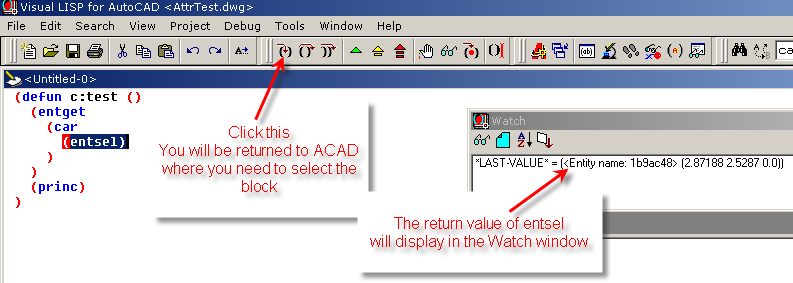

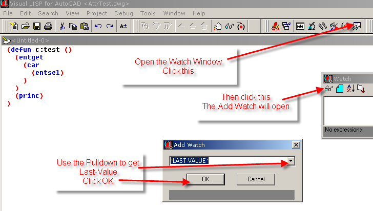

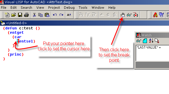

CAB
CadPro,
First set up VLIDE as follows:
From the pull down menus at the top select Debug & make sure the "Break on Error" is checked.
From the pull down menus at the top select Tools/Enviornmental Options/General
Activate the Diagnostic Tab
Check Report statistics...
Check Print notification ...
Check Echo PRINx ....
Check Inspect drawings....
Second Using you sample code to look at enter it into the vlide editor:
(defun c:test ()
 (entget
   (car
     (entsel)
Third From the pull down menus at the top select Tools/Load Text in Editor
Use the pictures to help you prepare for a test run.
Activate ACAD and enter test at the command line. When you hit enter you should be taken
to VLIDE with (entsel) highlited.
Note that most functions return a value. Some time you don't care what that is and some times you do.
That's all I have time for today.
