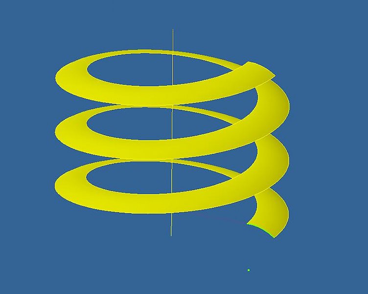

Hi.
I don't think it's so much industry specific, but just general modelling basics and understanding work methods of doing things in Inventor as I (and no doubt others) have found differences between the CAD platforms I've used. I'm still learning Inventor so am very new to most of it's functions, with many still be discovered.
Where I've come across having to use this is having a helix and wanting a plane tangent to the centre axis to pass through the end point of where the helix finishes. Being only a helix, I would have no two work points about the axis.
Regards,
David
I only have an older copy of inventor in front of me and i cant remember about helix creation in 2010 off the top of my head but when creating a helix based mixer blade like in your other post (in this older version) i would draw a profile of the blade on the XZ Plane using the intersection of it with the projected point of a line through the origin(seen as a green arc profile and a faint red line coming from the vertical yellow Z axis). Then use the Z axis for the coil based feature. That requires no additional planes and your standard plane. In the coil based feature you control the pitch, revolutions etc. If you wanted a plane based on this feature you could select two end points and the mid point of the end of the feature. Since you also know the angle of revolution based on your inputs you can select a standard plane(like XZ) then your Zaxis and enter a rotation angle to create a plane.
Of course this works for simply planar blade profiles but once you change that you have a bit more work. The use of standard planes and the origin for the base of your drawings is the best starting point. Do you have a specific file you are playing with where this comes into play?
Hmmm. Understand what you are saying ...
See above screen shot. This is the end side of the helix (surface) and I have put a radiused the inside corner. Rather than sketching something to find out what angle this point will be from an origin plane, and recalculating the angle should the helix length change (in turn will change end location where the helix terminates), or some other means, I want a plane that's governed by the highlighted point and tangent to the main axis of the helix. ...
While saying this, I just tried something and I think I've got an easy way around ... :shock: I can create an axis parallel to the main helix axis through the point, in which case then I can create my angled plane defined by the two axis!
Whoohoo!
Thanks so much - you lead me on the right train of thought! :)
