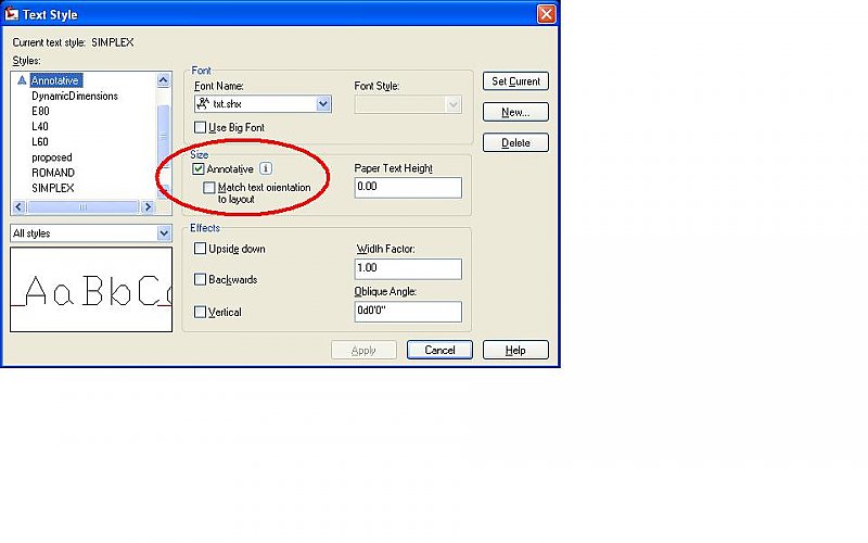

Why is it that the text style does does not have a scale setting similar to the dimension style?
There is in a roundabout way...it's annotative text

I believe that this problem has been solved.
Thank you to "Ipseifert" for coming to my rescue regarding text scale
