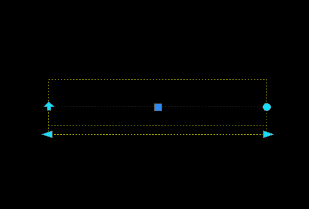

I have a dynamic block i have created that shows a steel angle in elevation view. It has attached stretch actions at both ends with a flip and a rotate action at the centerline.
My question is once I insert this block and stretch and rotate it to the angle and length I want - now I want to incorporate different size angle with the visiblilty command.
I want to use the visibilty parameter but i'm having a problem - when i switch visibility states it changes to the new size short length but not the changed rotation and length i wanted it?
Can you have a parameter that does an action for multiple visibility views?
I always make my blocks with all visibility bits on view. It is easy to fail to add your new bit to the action set. Make sure you can see it all (with the toggle that greys out the non visible bits) and then ensure all like items are in the action sets you are interested in.

you have all your visibility parameters setup correct? why not apply the same stretch actions to all the visibility states? you can choose what type of angle iron you want to use first? the stretch actions dont apply to all visibility states just because you did it on one.
Your right Todd - I just figured that part out- now it works - the only thing is that the action grip point will be on different places releative to the original angle size i created. Or is it possible to move an action grip point of a single action on different visibility state to different locations?
glad you got that part to work. dynamic blocks are at times a beast and i've only gotten my desired result with trial and error most of the time. I dont think the action base point transfers across to the different states you'd have to add those in as well. can u post the dwg so i can take a look at what u got goin on in ur dynamic blocks?
I know what you mean! Here you go - thanks!
is the block that you are doing inserted in the dwg? in the file you posted I couldnt open the block to check it out?
That was the block itself - Try this one - its a scratch dwg with the block inserted.
