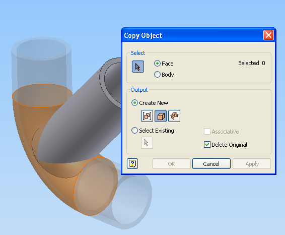

sakne79 Posted January 24, 2010 Posted January 24, 2010 Using frame generator to made car chasis. Two tubes conected under angle. One tube attached to another at bended angle not on strait surface. How to notch or trim second one for nice connection? Inventor not aloud to notch it. Only strait tubes. Quote
JD Mather Posted January 24, 2010 Posted January 24, 2010 Copy Object as surface and then Split or Sculpt. Attach your files here if you can't figure it out. Quote

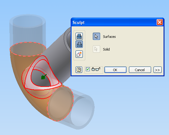

JD Mather Posted January 25, 2010 Posted January 25, 2010 Those are bitmap pictures, not ipt or iam files. Make the part you want to trim active (in the iam). Select the Copy Object command and then select the part to be used for trimming. Set the ouput of the Copy Object command to be a Surface body. You can now use this surface body to Split Part or Sculpt Cut the part you want to trim. If you post two ipt pipes in one iam here I can demonstrate if you can't figure it out. Quote

JD Mather Posted January 25, 2010 Posted January 25, 2010 Only need to copy trimming faces as surfaces as shown in images. And this only applies to bent sections - the rest can be trimmed with standard frame generator tools. Quote
sakne79 Posted January 25, 2010 Author Posted January 25, 2010 Only need to copy trimming faces as surfaces as shown in images.And this only applies to bent sections - the rest can be trimmed with standard frame generator tools. Yes, I understand that. Thank you very much! Your solution help me lot. Did all sculp job. In previous question I was talking about different things. What to do with assambly file and there generated tubes. How to made them as parts? Here are my question again: So, each frame generator tube in assambly should be copy in to new part file after creating? All main frame can be created in one part file? Or each part should be created separatelly? Quote
