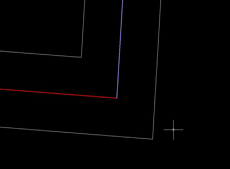

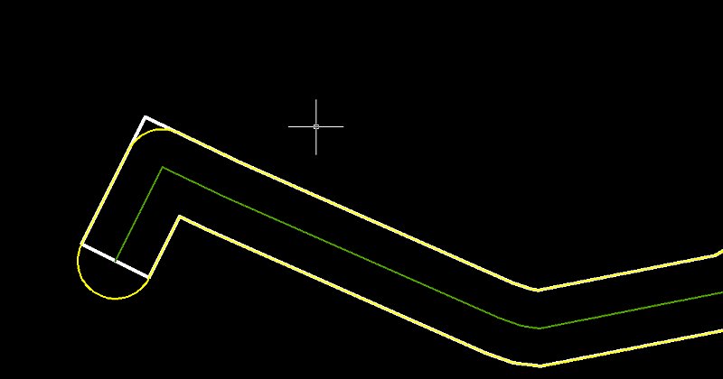

I'm trying to create buffer zones around polylines. My problem is that I need buffer zones with square edges, map3d only creates buffer zones with round edges which is useless to me.
By using multilines to create the two parallel lines I was able to achieve progress, but at the end of lines the connection is not seamless. I'll post pictures of what I mean.
The first picture shows the difference between what autocad can create and the kind of buffer I need. The white line is what I need, the yellow one is the buffer generated by autocad.

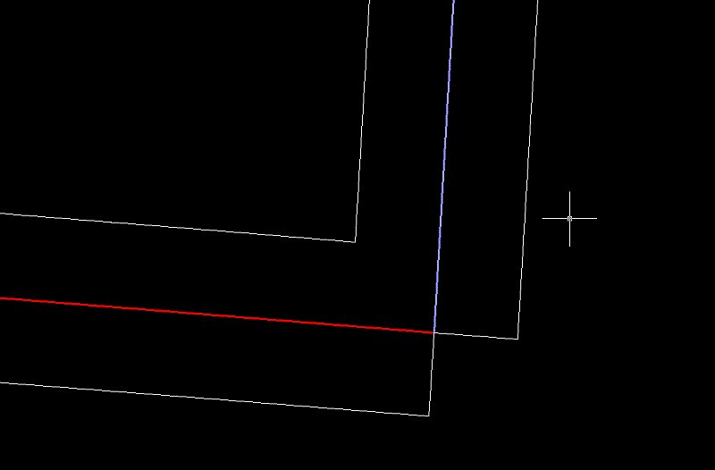

The second picture is my problem, that if a line ends at a vertex and continues as a new line, the region created with multilines will look like this, which is obviously not good.

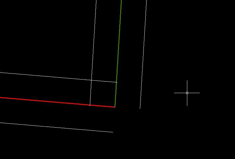

The third picture shows the correct version where I need to get.
So either I need a complete program that can create square buffer zones correctly, or I need a solution on how to edit the line in picture 2 to get the result as shown in picture 3.

Hows this?

If I understand this only offsets the line to each side. The result is no different than using mline.
I thought you said that you need to get the third pic?
That is what my code achieves.
You might want to look into the TRACE command. You have to do some additional work for closed paths. Extend the trace so that it repeats the first 2 segments. Then erase the last and first trace segments so the joints are angled. -David
PS: You can do the same with PEDIT Width, but there is no access to the corner points whereas traces tell you the whole story.
It should look something like this:

If its one continous line, but its not. Your code does this its no closer to what I need, than what I already have.
You should be able to trace the lines you have and the outer "jacket" will be produced.
I'm going over, polyline verticles one by one, if for example two lines meet by their end, I would have to trace it backwards, which would mean a lot of coding. Also if not just two lines meet then I'd have a problem.
