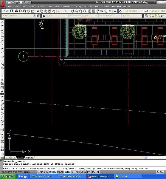

I have a problem with my Autocad 2009.When i am try to Save/Saveas/Open a file the options are coming to the command line.here i am attaching the screenshot .please advise.normally a new window will come for the Save/Saveas/Open option.any default settings changed???o:)
Regards_______
Set FILEDIA to 1

Thanks a lot CarlB.
