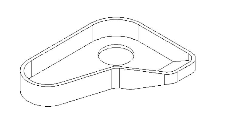

DJ Hands3 Posted January 28, 2010 Posted January 28, 2010 Hello everyone, been practising a mock for a city & guilds exam and I'm having trouble with the attached practice mock. What I'm struggling with is the fact in Isometric your not suppose to use the offset command but copy and offset the distance instead, this is the part where I'm getting stuck as the isometric ellipses are not easy to do this with, lines are fine if anyone can explain the process to do this would be of great help :wink: all attached in needed to answer the question, thanks mockIsometric.pdf Quote

rkent Posted January 29, 2010 Posted January 29, 2010 Hello everyone, been practising a mock for a city & guilds exam and I'm having trouble with the attached practice mock. What I'm struggling with is the fact in Isometric your not suppose to use the offset command but copy and offset the distance instead, this is the part where I'm getting stuck as the isometric ellipses are not easy to do this with, lines are fine if anyone can explain the process to do this would be of great help :wink: all attached in needed to answer the question, thanks I am not certain of your exact needs. Once in iso mode (snap, style, iso) the ellipses are made with the ellipse, isocircle option. You are correct in that you don't use offset with iso drawings, simply copy with ortho on and the iso plane set to the correct one (ctrl+e or F5). For the object shown you want to draw an iso rectangle the size of the object and then start locating points needed along x and y axis. Copying the lines in each direction to locate the center of arcs, circles, non-iso lines, etc. Quote

Bill Tillman Posted February 3, 2010 Posted February 3, 2010 Why trace it. I started at 7:34 PM and was finished with the model at least at 8:00 PM. Took a small break in there too. 3D is still some fun stuff with AutoCAD. I drew this all in 2D then made solids. A simple offset got me the insides then I did a little, extruding, slicing and subtracting. Quote

Bill Tillman Posted February 3, 2010 Posted February 3, 2010 Some folks will call me a simpleton, but I draw all of my 3D stuff in 2D. I'm not really comfortable with the ISOmetric screens. I should be as my original exposure to isometric drawing was with a 60/30 triangle on a drafting table. It's not that difficult to create this drawing but you will need the to understand a few things about creating shapes and solids in AutoCAD. In a nutshell I basically took these steps: Layout the center points of the circles which formed the radiused corners. Establish the edge lines of the outside surface using the dimensions shown along with the circles created above. Cleaned up the outline of the outer surface using TRIM and drew a few lines using the TANGENT function. Once I had the outside shape defined I used PEDIT to group all the lines together in a polyline. Then I offset this shape by 3 units towards the inside to get the inner surface. Converted both of these into REGIONS. I then EXTruded the outside surface to the desired thickness. Switch your view to either left or right so you can see the drawing from one of the sides. Either one will work just adjust the next steps accordingly. I drew two lines to establish the points of a plane on which the chamfer towards the front of the part will be. Then I sliced the newly created extrusion along this line to get the final shape of the outer surface. Next, offset this slicing line by 3 units towards the top of the shape to establish the slicing plane for the inner surface. Now move the inner surface outline created earlier up by three units and EXTrude it to the proper depth to match the outer surface. Then SLICE it along the line you offset and erase the splicing lines as you won't need them anymore. Now set your view from the top and SUBTRACT the inner surface from the outer surface. Then draw a circle for the 15R hole at the location shown. Turn this into a REGION and EXTRUDE it to 3 units. Make sure you EXTRUDE this in the right direction otherwise you may have to move it to its final location. Then SUBTRACT the hole from the now hollowed out shape. There you have it. I'm sure there are other creative methods. That's the best part about AutoCAD and especially this forum. You can find out how others would create this drawing. And remember, as Merlin said to King Arthur in "Excalibur": "There's always someone out there cleverer than yourself." ...and he was talking about a fish! Quote

DJ Hands3 Posted February 17, 2010 Author Posted February 17, 2010 Bill thats some good stuff man, I'v had another go here's my latest attempt almost there but some angles are messed up, cant understand how to get the 57 degrees. Emailed my teacher to see what's wrong but no reply.. Well i suppose its half term. Can any one recommend any good CAD DVD's to learn from? Our teacher shows the task once with a hand out and then its up to us I work as an electrician so out side the class no pratical hands on - at least I got the student autocad 2010! isomock.dwg Quote
Bill Tillman Posted February 17, 2010 Posted February 17, 2010 Looks like your getting the hang of it. I'm not sure what you're meaning by the term 57°. I used a much different method, staying in the plan view of the World UCS all the time. I changed the view a few times to get the results needed. But for me, drawings along an isometric axis is not something I do unless there is no other way. Keep practicing. You'll get there. Quote
DJ Hands3 Posted February 17, 2010 Author Posted February 17, 2010 Looks like your getting the hang of it. I'm not sure what you're meaning by the term 57°. I used a much different method, staying in the plan view of the World UCS all the time. I changed the view a few times to get the results needed. But for me, drawings along an isometric axis is not something I do unless there is no other way. Keep practicing. You'll get there. the 57° is shown on the attached pdf, but still I thought isometric was all 30° angles? Quote
Bill Tillman Posted February 17, 2010 Posted February 17, 2010 An isometric drawing can be drawn using just about any angle. In fact, when you think about it there are at least 360 different angles (in degrees anyway) to draw something. It's just that your brain and line of sight have to be keener to do this but it could be done. The images may look a bit out of whack. The only reason most isometrics are drawn on 30° is that most drafters were equipped with a 30/60 degree plastic triangle (straight edge) and this 30° angle produces an image that easier on the human mind and eyes to look at. Again, I go back to my method of drawing this shape. Just lay it out using the World UCS and you're there. That's my approach anyway. Quote
rkent Posted February 17, 2010 Posted February 17, 2010 You are drawing in 2D Iso, you can't draw or dimension angles like the 57 you asked about. You can either locate points along the iso lines like you did and connect the dots, or do a true Iso projection, but that would require too much to cover here. It is a shame there are so many instructors that do such a poor job of covering this stuff. And of course, teaching 3D would be a lot more worth while than Isos, and this coming from someone that loves drawing in Iso. Quote
DJ Hands3 Posted February 23, 2010 Author Posted February 23, 2010 Had another attempt, my teacher did email me back and advised me what to do heres the result check the dwg isomock.dwg Quote
Bill Tillman Posted February 24, 2010 Posted February 24, 2010 Nice work, looks like you're getting the concepts your instructor is trying to pass on. I myself would prefer to draw this using World UCS and let the angles take care of themselves. Also I noticed that you didn't create any solids with this model. Not that they are required but if you wanted to add materials and render this object that will be the next step you will tackle. I'd suggest learning as much as you can about moving and aliging the UCS. This is kind of hard to grasp at first but once I got this along with REGION, EXTRUDE, SLICE and SOLIDEDIT commands understood, 3D has become simple. Quote
