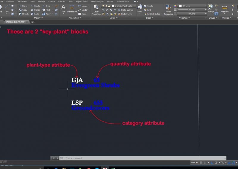

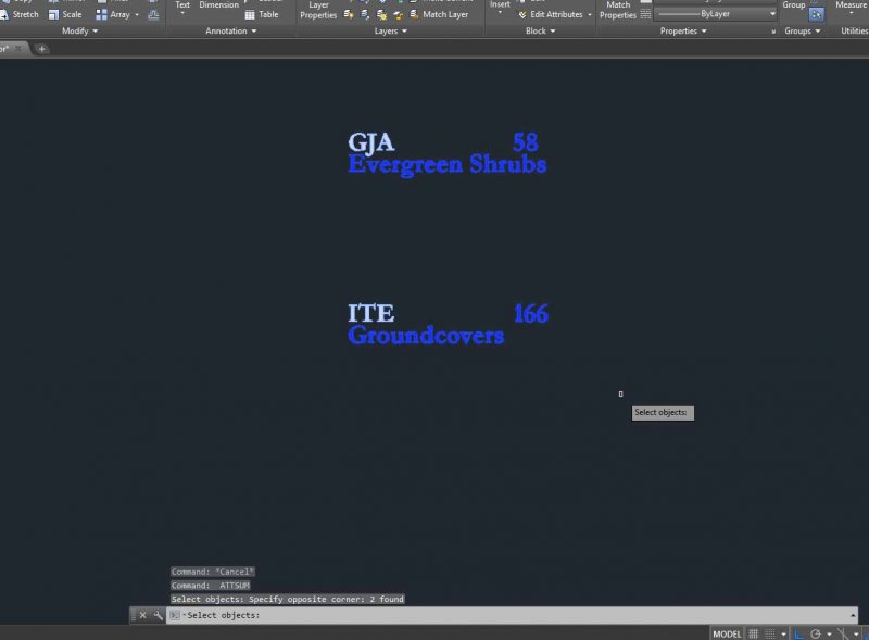

So here is what happened. I opened a CAD file, created 3 attributes namely: plant-type, quantity and category. Next I created a block out of those attributes collectively, named 'key-plant'. To experiment, I inserted 2 of those blocks with their own details, as shown below:

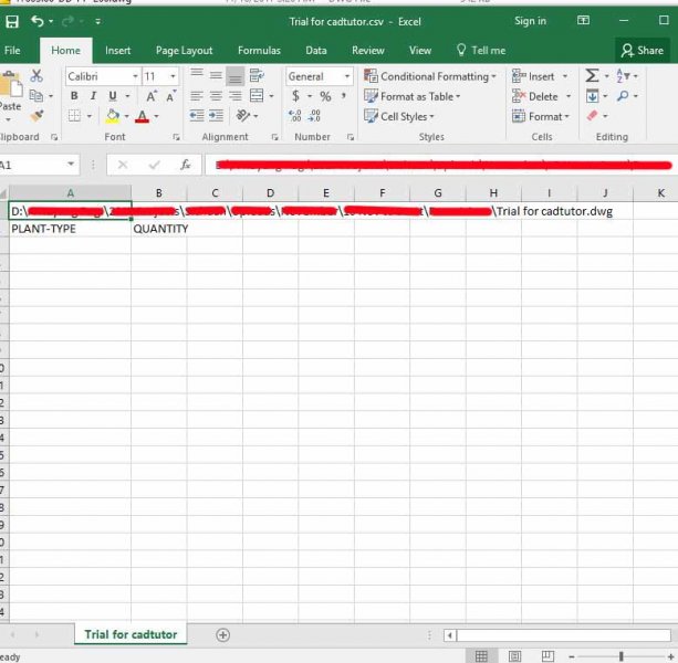

Then as instructed by Bigal, I loaded the attsum, windowed the aforementioned 2 blocks (2 blocks selected; acknowledged by AutoCAD), then an excel file was created. I opened that excel file and found this:
As you can see, there is a filename location above, then 2 parameters namely the PLANT-TYPE and CATEGORY only. There were no further details that followed. Could have I made a mistake in the procedure?
Have you updated the 'Attribute Tag Names' section to match your tags (note: use CAPS)?

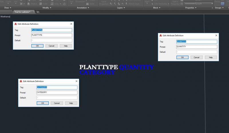

Thanks for the suggestion, Roy_043. I tried using capital letters in the tags before creating the 'key-plant' block, as shown below:
But I still got the same excel result. :(

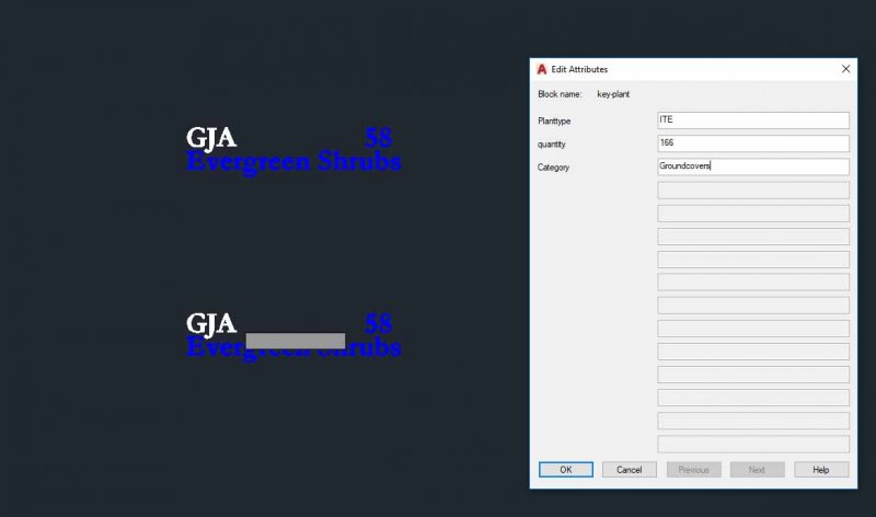

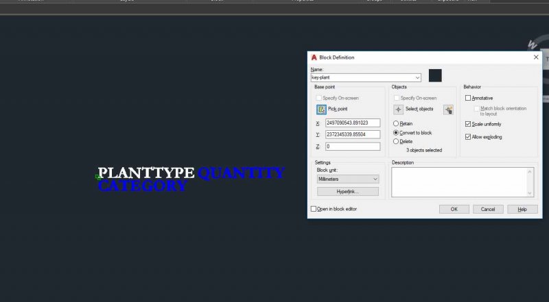

@Roy_043, sorry I'm a total newbie at this, so I don't know how to execute that last instruction. What I can do is show you the steps I did. First off I created 3 attributes that indicate 'PLANTTYPE', 'QUANTITY' AND 'CATEGORY':
Second, I created the 'key-plant' block:

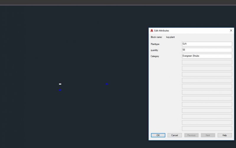

3rd, I inserted a 'key-plant' block called 'GJA':
and another one called 'ITE'

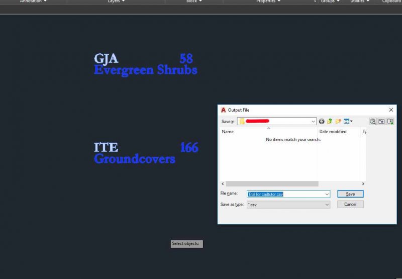

Next, I executed the ATTSUM command with the 2 blocks selected:

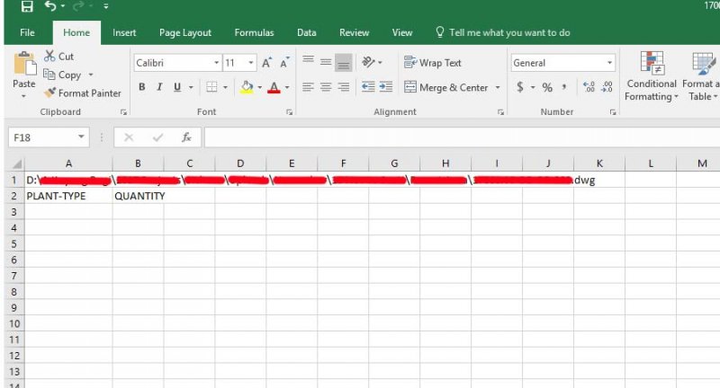

Then an excel file was created:
I got the same excel file as before. Just the 'PLANT-TYPE' and 'QUANTITY'. No indication of the GJA and/or ITE and their details.

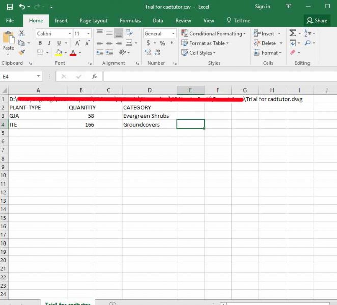

I was hoping to have something like this:
There could be a lot of mistakes that I did and in fact, I don't know how to do the instruction you provided. Please bear with this newbie soul.

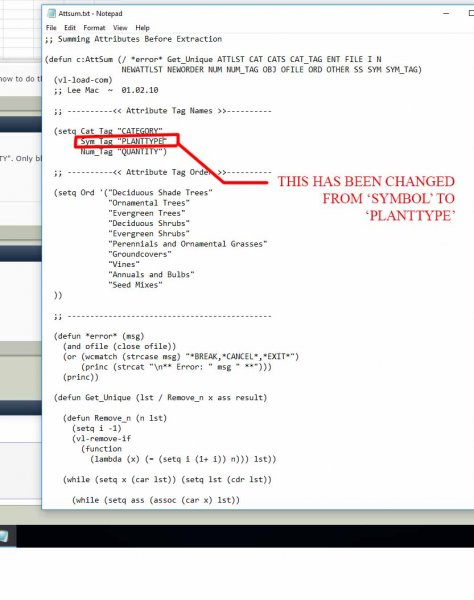

The code looks at three tags: "CATEGORY", "SYMBOL" and "QUANTITY". Only blocks that have attributes with all these tags will be processed. So you must change "SYMBOL" to "PLANTTYPE" in the Lisp code.
  • 1 month later...

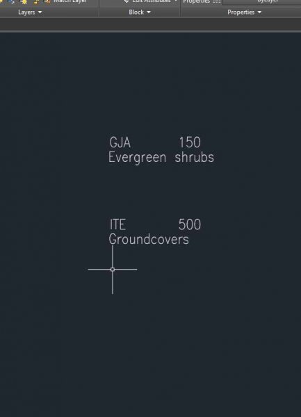

Still no cigar. I renamed the attsum to a text file, changed the 'SYMBOL' to 'PLANTYPE' then convert back to lsp file:
Made the blocks as per previous steps:
Loaded the attsum, then generated the excel file:
As you can see, this is still far from the desired output. The planttype codes (GJA and ITE) and quantities (150 and 500) still do not appear in the excel file. :(
FYI - lisp routines that are not compiled do not have to be renamed as a text file in order to edit them. They are typically ASCII text files to begin with which means they can be opened with any ASCII text editor such as Notepad.
The code from post #21 is faulty. Use the code from post #14, change the 'Attribute Tag Names' as before and things should work fine.
  • 4 weeks later...
Worked! Also found out that the resulting excel file could not be overwritten correctly. A new list shows up on top of the previous one (in the same excel file), so it is best to do the attsum command when the drawing is absolutely finished. Or simply erase the old excel file to get a fresh new updated one. Thanks Roy_043 and LeeMax! See you in the other threads!
