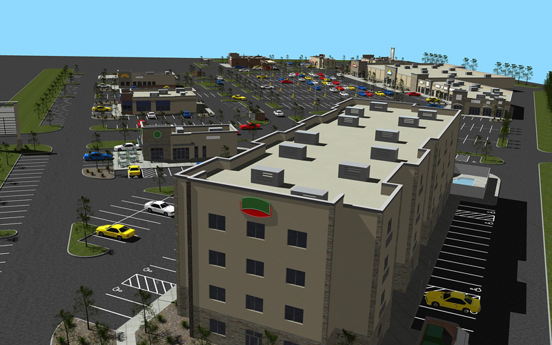

Izzi1212 Posted August 14, 2008 Posted August 14, 2008 I have been having a ton of trouble with AutoCad 2007 while doing a 3d rendering. I am trying to render a 3d site plan consisting of 10 very basic buildings (exterior walls, roof, glass, window frames), and some other basic site planning elements (trees, curbs, grass, pavements, and sidewalks). Now, everytime I try to render the site (still or motion), CAD closes, sometimes with an "error handler re-entered" or "fatal error" message and sometimes just a fatal error sound. I feel that my computer should be more than capable of handling this task, but is not. I have updated CAD, my video card drivers (AutoCAD drivers from nvidia), closed all background programs, deleted (purged) all unnecessary items from the drawing, and audited the drawing for errors. The drawing consists of no xrefs, just 3D solids and a couple small blocks. Does anyone have any ideas? Is it me? My computer? CAD? My Computer Specs: AutoCAd 2007 Dell Precision WorkStation 690 Windows XP Professional Service Pack 2 3.00 gigahertz Intel Xeon64 kilobyte primary memory cache4096 kilobyte secondary memory cache 3070 Megabytes Installed Memory NVIDIA Quadro FX 4500 512 MB I would appreciate any help, suggestions, or advice. Thank you! Quote

papagyi Posted August 17, 2008 Posted August 17, 2008 My experience,this would be happen for memory error.Mostly were solid modeling.I always use for rendering with (surface 70% + solid & thickness 30%).New file and all copy from error dwg for eliminate error if old file might be some error."Brep" for reducing memory form your solid memory.Autocad normally record for solid history(eg.union or substract with two solid model).You can get original two solids object after union or substract by change value 0 to 1 for showhistory system variable(pls check for showhistory system variable from help).So you should need to "brep" for parmently delete solid history,if you will be sure for your model. Goodluck my friend. Quote
Izzi1212 Posted August 17, 2008 Author Posted August 17, 2008 Thank you, I have copied and pasted a new file and also used the brep command, but AutoCAD still closes when I try to render an image of the site. Quote
papagyi Posted August 17, 2008 Posted August 17, 2008 Pls check this link ...http://usa.autodesk.com/adsk/servlet/ps/dl/index?siteID=123112&id=2334435&linkID=9240618 If you can't solve this,pls can you post your error file?Next time you will be do for next project,pls use mostly surface model. Quote

papagyi Posted August 26, 2008 Posted August 26, 2008 oK..pls wait for my detail reply.I will give some sample for you. Now you can off "hardware acceleration "and render again.I believe that is memory error.If not ok,you should close all layer and reopen one or two layer to render again.This step by step layer open and render will be found what state will be done "fatal error".My experience,some project with 3d solid to print black&white for "hide" that was done "error".Then i was close some hatch and again hide,this was fine.Pls never surrender for this error. Quote
Izzi1212 Posted August 29, 2008 Author Posted August 29, 2008 I have converted my model to mostly surfaces and planar surfaces, including all of the buildings and I still cannot render this file. It makes it through about 40% of the rendering and then CAD just closes. I also had my computer guys monitor my computer resources while I did this, and they confirmed that this is not a hardware issue, AutoCAD is not even using the full capabilities of the hardware that I have installed. Any thoughts? Thank you again. Quote
