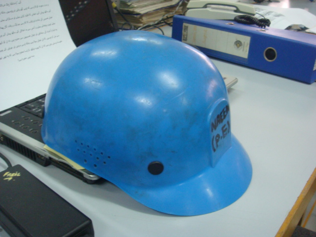

Kindly help me to draw a 3d helmet in cad 2010.
humair
I think a REVOLVE should do most of it. Then a SWEEP for the brim.
If the helmet is wider, front to back, than it is side to side I'm not sure that a simple Revolve would achieve the correct profile. As for the brim would Rulesurf be a good option using a portion of the front of the helmet curve and the edge of the brim as the two lines that could define the mesh? Just thinking out loud here. There are probably two or three other ways to achieve the same goal I haven't even considered (lack of coffee...must have coffee...now). The task is brimming with possibilities! My mind perks with ideas!
