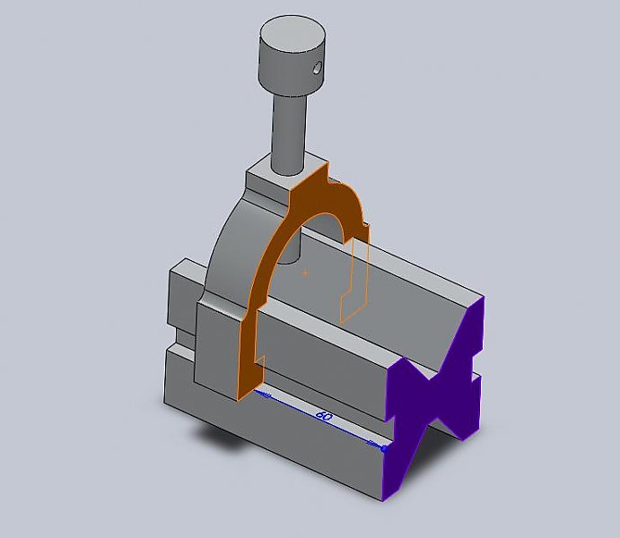

Depends on the part and other mates. If you select two planes, they remain planar. If you select two edges, you now have the ability to rotate (potentially). Its good practice when you are creating an offset mate to use faces when possible. It will also give you a little bit of freedom with your other mates. Lets say there wasnt a distance and it was only a coincident mate. If you selected two edges, the parts can both translate and rotate in multiple planes. If you selected two faces they could only translate and rotate in one. If you had no other mates besides the offset using edges, the model would be unstable.
Make a simple model and play around with it.
Mostly, here is a similar example showing you the highlighted selection.
