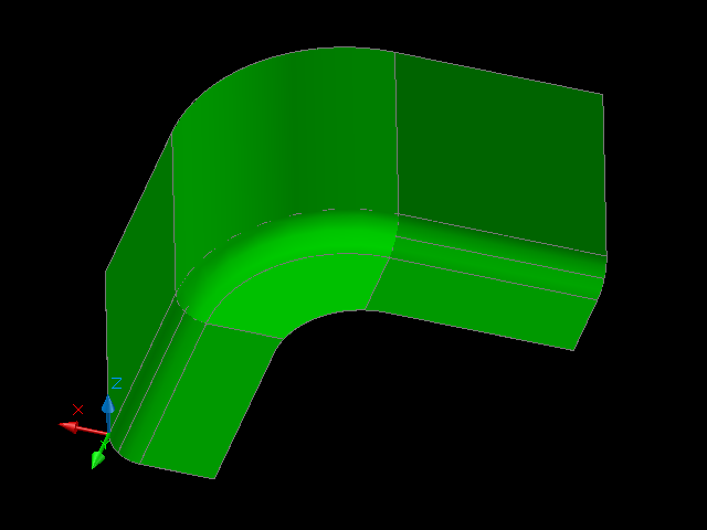

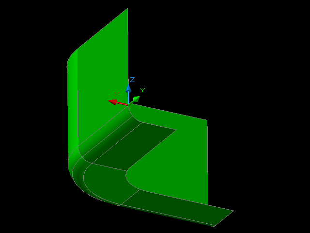

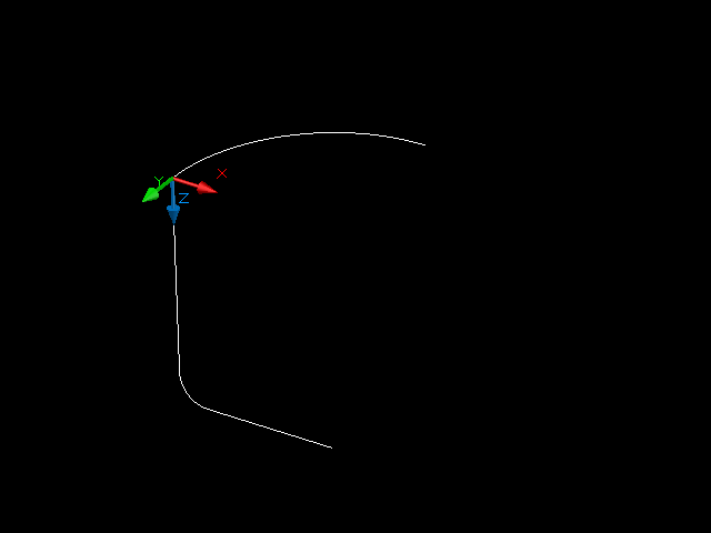

If you already made the profile and extruded the screen you can also sweep that profile along an arc perpendicular to your profile. Change your UCS to draw the arc to sweep.
Then thicken your surface to create a solid.

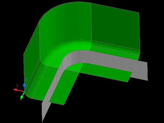

Then you can offset the arc and create another surface to be used as a slicing plane.
