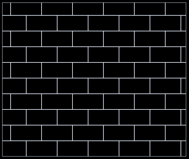

I am trying to create a custom hatch pattern and not sure how to do it.
i need to make a 6" x 12" brick with 1/4" grout lines. I also need to make a 12" x 24" brick with 1/4" grout. The hatch needs every other row to be offset (standard running bond pattern). Can someone help me?
My cyborg twin brother said you might be looking for something like this?
6x12 running bond with 1/4" grout joints.

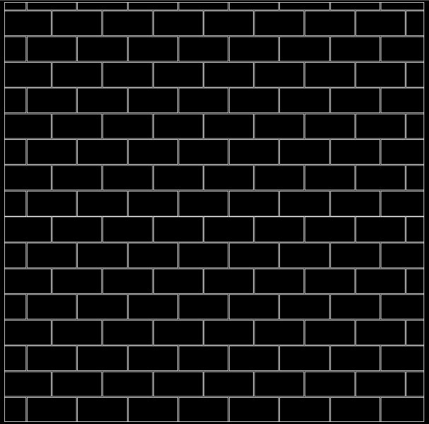

I understand you are also interested in a hatch pattern like this too.
This one happens to be 12x24 running bond with 1/4" grout joints.
Note: units are imperial.
