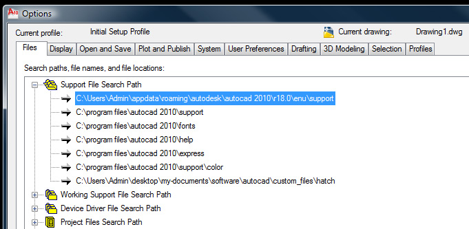

Open Autocad and go into your Options. Click on the "Files" tab and then Expand the "Support File Search Path". The first line in that section should tell you where your acad.pat file is located on your computer.
Thanks Cad
I notice on your options you have as your last item files\hatch
I don't have this, I have nothing after support\colour
Can you tell me where mine is??
Dodge
Don't sweat it, you hatches will be in the place Cad64 described.
Cad64 must have some extra non-standard hatches. Rather than save them into Autocad's support folder, he has added an extra search path...

That's correct. I added that search path so Autocad can find my custom hatch patterns. I keep them outside of Autocad's support folder so they won't get wiped out if I ever need to re-install.

1. OPTIONS, "Files" tab, click "Support File Search Path" so that it's highlighted
2. Click the "Add" button
3. Click the "Browse" button
4. Navigate to the folder where your custom patterns are saved
5. Click "OK" to accept the new support path
6. Click "OK" to to save changes and exit Options
