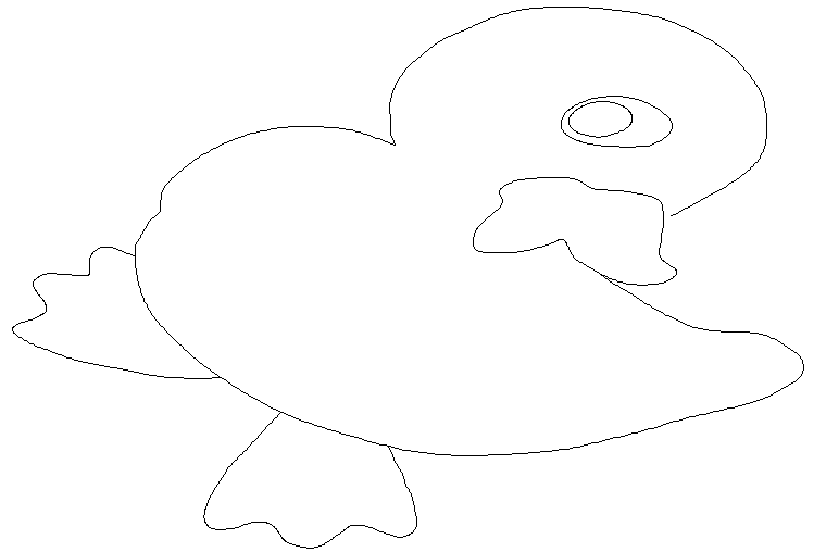

Sometimes I have a pline that isn't closed. How do I make it show in a 3d render?
Extend the line to the duck's bill then trace around (duplicate) the portion of the bill until it meets up with the body and Pedit/Join it.
You can try to give it some thickness. Also _.PEDIT _Width. Just don't explode it or you will loose the width data. -David
