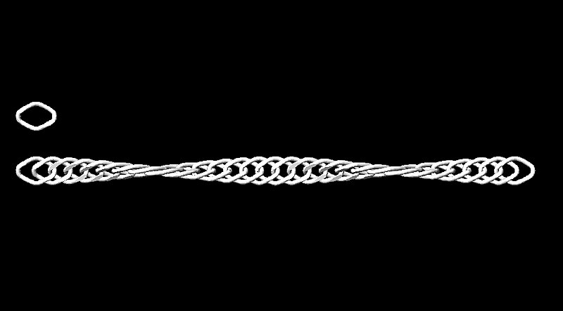

Hi All,
I need to make a twisted chain, and always do with the two commands.
At first I array the object then 3drotate it one by one manually, but it need a lot of times and patients to get the twist result.
I've been posted this thread in the general forum and Pablo Ferral suggests this to me:
"Could you use a script or a lisp routine? Have you tried posting in the customisation forum?".
I know how to use a lisp routine but I don't know how to make a lisp routine.
Is there a lisp routine for array an object in a row and 3drotate it all at once?
Is there an Autolisp tutorial to learn, because I need to make this shape in several sizes?
Thanks for help.:)

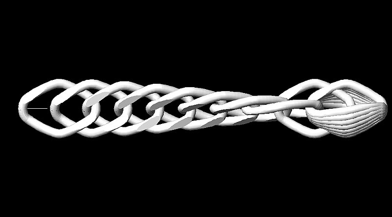

Hi All,
Thanks for help.:)
On simple somehow here so:
(defun c:test (/ ptim t1 t2 kol ugol)
 (setq	ptim (car (entsel))
t1   (getpoint "\nInitial a direction point: ")
t2   (getpoint t1 "\nFinal point of a direction: ")
kol  (1- (getint "\nCopying number: "))
ugol (getreal "\nAngle of rotation: ")
 (vl-cmdf "_copy" ptim "" "_non" t1 "_non" t2)
 (vl-cmdf "_rotate3d" "_last" "" "_2" "_non" t1 "_non"	t2 ugol)
 (repeat kol
   (vl-cmdf "_copy" "_last" "" "_non" t1 "_non" t2)
   (vl-cmdf "_rotate3d" "_last" "" "_non" t1 "_non" t2 ugol)
If all as wanted, then it is possible to add the output agent of errors, input by default...

For Geobuilder
I've been Tried the test.lsp and it works, but the last copying objects seem rotate3d in one axes. It should array just like the previous copies. The distance of each link is 1.03 mm. Am I inputing wrong number?
Command: test

ica_cici, No so should not be.
Please, show the drawing DWG file, and copy from a command line all course of performance of the program

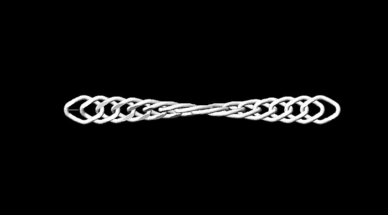

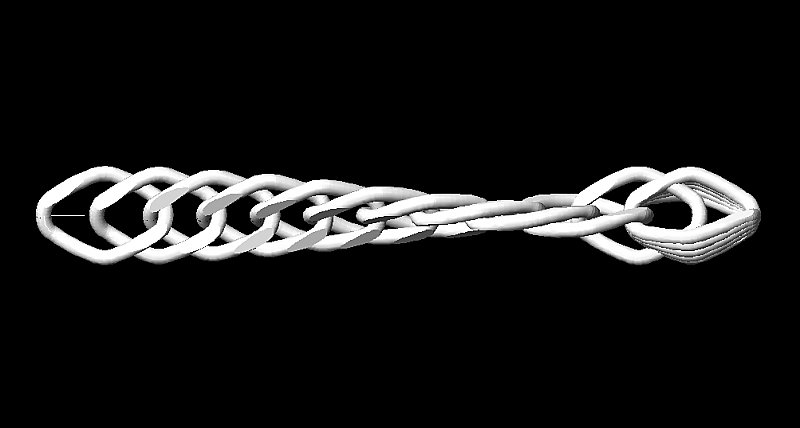

I try the lisp once more and now I think I know what is caused the problem. It seems that zoom in and zoom out had an effect on it (see test1.jpg & test2.jpg).
In the second picture I apply zoom in so there are more space in the screen than the first picture and get the perfect result.
Looks like screen appearance bounded the array process. (sorry it hard for me to express in english)
