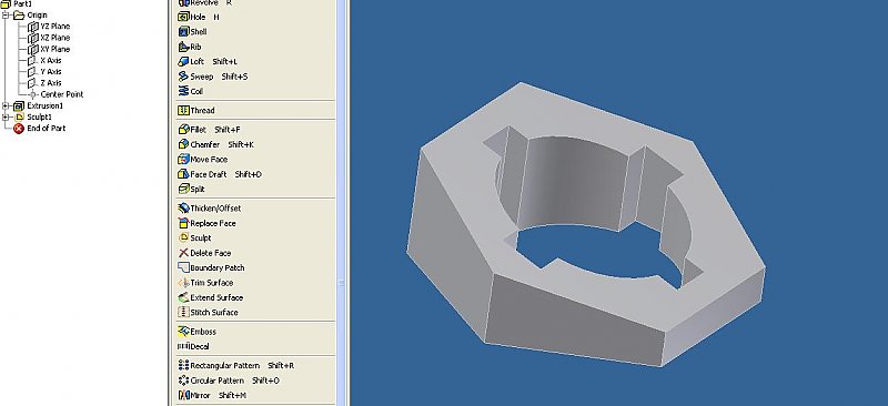

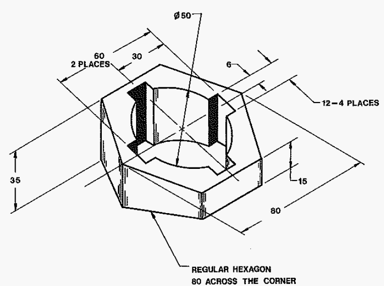

bmiller1156 Posted February 10, 2010 Posted February 10, 2010 This is my first post. I am new to inventor 2010 and this drawing is driving me crazy. I have searched this site and all over the web, but I don't seem to be finding an answer. Very remedial problem. I have attached a picture of what I am trying to acomplish. I can make the 2D part no problem. I then extrude to 35mm. Now, how do I acomplish the angled surface? I have tried to split but I need to be able to measure the line height on each side of the part to acomplish the split correctly. Work planes don't seem to allow me to measure either. I am sorry that this is such an easy problem. I can't believe what some of you all are doing with inventor on this site. Amazing. Any help would be appricated. Quote

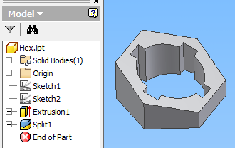

JD Mather Posted February 10, 2010 Posted February 10, 2010 As you probably suspected this is a trivially easy part. Attach what you have completed so far and I'll show you the solution. Assuming you modeled with a hexagon sketch (with horizontal line at top and bottom) on the xy plane and extruded 35mm - Start a new sketch on the yz plane. Project Geometry the top top horizontal edge. Project Geometry the bottom bottom horizontal edge. This will create two projected points on your sketch. Sketch vertical line at bottom bottom projected point and dimension 15mm. Connect the remaining point with a line and then exit sketch. Select the Split command and change the option to split part. Select the line as the split tool and the the side (top) to trim away. Hex.zip Quote

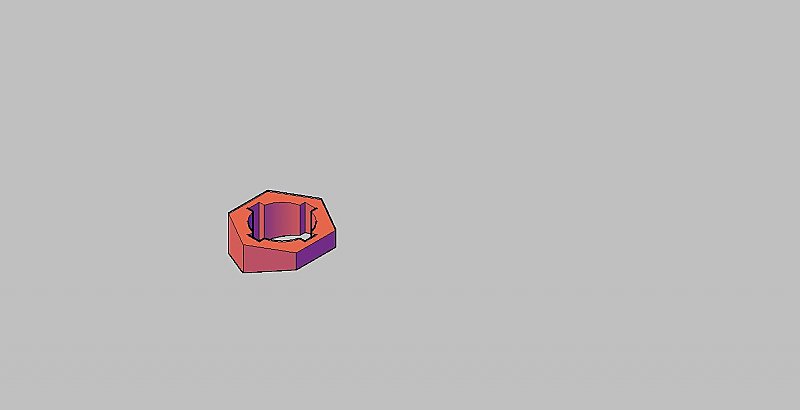

ReMark Posted February 10, 2010 Posted February 10, 2010 For some reason I thought it would be easier in Inventor. In AutoCAD it was make the two required profiles, use Region on them, Subtract one from the other and Extrude. Create a surface (at proper angle) then use the Slice command with the Surface option. Fairly involved. Result: Quote
JD Mather Posted February 10, 2010 Posted February 10, 2010 For some reason I thought it would be easier in Inventor. In AutoCAD it was make the two required profiles In Inventor two sketches (profiles). (no regions needed - Inventor allows mix and match of picking enclosed areas without creating polylines (which are non-existant) or regions - similar to AutoCAD presspull except allows multiple picks (not needed for this problem)) One Extrude. One Split (slice). Quote

bmiller1156 Posted February 10, 2010 Author Posted February 10, 2010 JD Thanks this helped. I've attached what I ended up with. I ended up using my dimension lines to anchor the points. I've only been using inventor for about three weeks so I run across a lot of little things like this. Thanks to everyone for the help! P4-32.zip Quote
JD Mather Posted February 10, 2010 Posted February 10, 2010 OK. Seems much simpler when I read it now. Thanks. Almost identical to AutoCAD except that I parametrically tied the two sketches together (Project Geometry) so that any change of any of the dimensions will cause the part to automatically update. Quote

linnmaster Posted February 10, 2010 Posted February 10, 2010 This is my first post. I am new to inventor 2010 and this drawing is driving me crazy. I have searched this site and all over the web, but I don't seem to be finding an answer. Very remedial problem. I have attached a picture of what I am trying to acomplish. I can make the 2D part no problem. I then extrude to 35mm. Now, how do I acomplish the angled surface? I have tried to split but I need to be able to measure the line height on each side of the part to acomplish the split correctly. Work planes don't seem to allow me to measure either. I am sorry that this is such an easy problem. I can't believe what some of you all are doing with inventor on this site. Amazing. Any help would be appricated. Hello there. I haven't had a look at the files attached on this thread, but is it just me that's confused? I feel it's a confusing drawing, because what it's trying to illustrate can be misleading as all dimensions detailing the cutout in the middle is done on the slanted plane, and that shows the true length of the notch width to 12, hence if you wanted the 4 notches to be 12 as shown, two will be 12 wide, and two will be less than 12 ... I'm assuming that the hole in the centre has all 4 slots symetrical, 12mm wide and 60mm across flat to flat, not true length distances. Regards, David Quote
shift1313 Posted February 11, 2010 Posted February 11, 2010 Hello there.I haven't had a look at the files attached on this thread, but is it just me that's confused? I feel it's a confusing drawing, because what it's trying to illustrate can be misleading as all dimensions detailing the cutout in the middle is done on the slanted plane, and that shows the true length of the notch width to 12, hence if you wanted the 4 notches to be 12 as shown, two will be 12 wide, and two will be less than 12 ... I'm assuming that the hole in the centre has all 4 slots symetrical, 12mm wide and 60mm across flat to flat, not true length distances. Regards, David I agree with you David. It does seem a bit odd. Quote
