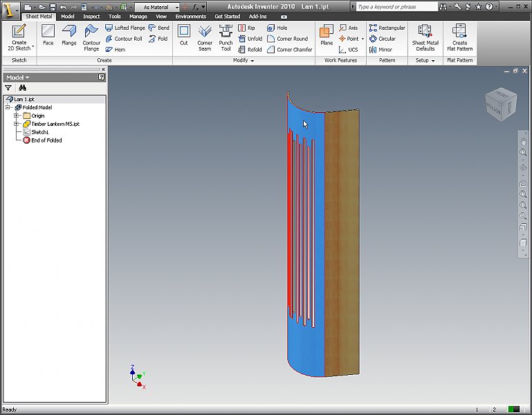

in a sheet metal part, in the graphic window

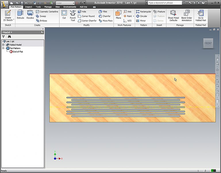

Pick a face>Click 'Create flat pattern'

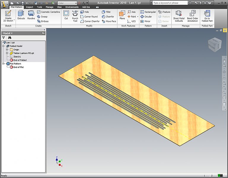

Flat pattern is created, the part is unfolded and shown flat, then all of a sudden it flips into an iso view automatically.

I figured it out, It only happens when I try to create the flat pattern whilst editing a part inside an assembly. I presume that this is beacuse it has to open the part first and the default view for the part on open is isometric.
It is opening the part, creating the flat pattern view and then returning to the default Iso view. Now I understand.
