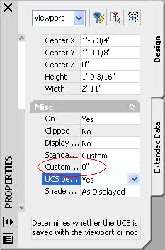

ReMark Posted February 11, 2010 Posted February 11, 2010 Then try this. First...open Properties. Second...click on your viewport. Then...look in the Properties palette under the Misc heading. See where it says Standard scale? Using the down arrow that will appear if you put your cursor near the end of that box select Custom. Now move down to where it says Custom scale (right below Standard scale). Type your new scale here (1:60). That should do it. Quote
CADMASTER1128 Posted February 12, 2010 Author Posted February 12, 2010 After I type in the new scale it still reads 0'' Quote
