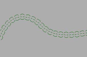

Pearly King Posted February 15, 2010 Posted February 15, 2010 Hello all. This is my first post and I'm new to CAD so please bear with me. I've been on a drawing board now for almost 20yrs. Tried CAD a few times but found it just took too much time to try and learn. Most of the drwaings I do are scale plans for Road Traffic Accidents. As you can imagine many of the kerbs and hedges do not follow nice clean arcs etc but I'm working my way through that. My question is this; Can a complex linetype be created so that if I plot a centre of a hedge and offset to each side to create a hedge thickness, can those lines that represent the edge of the hedge be changed to a linetype which looks like a hedge? ie curly lines. P.S. I'm using an old version of LT 2000 which I started to play with years ago when I first tried CAD Quote
eldon Posted February 15, 2010 Posted February 15, 2010 I initially tried to make a complex linetype, but then found the MEASURE command. I make a block of the correct hedge thickness, and send it along the hedge centre line, which I then erase. However, I don't know whether 2000LT has the Measure command, and you may have to resort to a complex linetype. It may be easier to define a shape, then use that in the linetype. Quote
Pearly King Posted February 15, 2010 Author Posted February 15, 2010 This looks like exactly what I'm after but being new to CAD I haven't got a clue how you did it? I don't seem to have a measure command only dimension or distance Quote

chomuth Posted March 8, 2010 Posted March 8, 2010 Pull Down Menu --- Draw>Revision Cloud This is how I make the bush or brushlines. Using this command you cant draw it faster by hand. I am not sure it's in the version you have. Cut that imbillical cord to your pen it's tough to do. I was sad when I had to many years ago Good Luck Quote
merdrignac Posted March 16, 2010 Posted March 16, 2010 Perhaps you could try "double lines" with the "zig-zag" line type. Not the most elegant solution, but quick and easy. Quote
