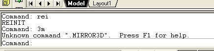

I am trying to pimp my pgp file to get all the keystroke commands as efficient as possible for the commands I use most frequently.
I use 3D Mirror a lot. I've created a button and a hotkey (ctrl + numpad3), but depending on the day or where my hands are, I also wanted to make an alias for it, such as '3m'.
The full command is '_mirror3d', with capitalization not mattering. Now, here's the weird part. I have added this alias to the acad.pgp file. I have tried all the different ways w/rt capitalization (i.e., _mirror3d, _MIRROR3D, _mirror3D, and _MIRROR3d). I save the file, reinit the pgp file, and type '3m' on the command line and hit enter. It comes up as _MIRROR3D regardless of which capitalization I put in the pgp file. And it says it is an unknown command. If I type the full command (in any of the capitalizations) on the command line, the command works. But when it pulls the very same command from the pgp file, it does not.
Any ideas? Also, this gives the same results with _rotate3d and _layerp, as examples. It seems to be the underscore commands that the pgp file can not create proper aliases for. I believe the underscore character before a command refers back to previous versions of AutoCAD or something like that. I have added/modified other regular commands in the pgp file with success.
Substitute a period for the underscore and see if that makes a difference.
The underscore before the command helps Non-English versions of Autocad understand English commands when they are typed at the command line. You should not include an underscore or period in your pgp aliases. Remove them and your alias should work as expected.

That's it!
