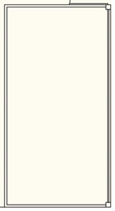

Basically I want the type of image that you see on your average set of non-color blueprints. I'd prefer that the file still be either a dwg or dfx file. I have attached an example of what the result would typically look like.
