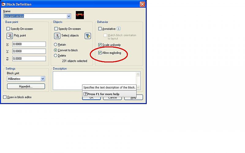

DNK Posted February 16, 2010 Posted February 16, 2010 Enter in the Block command. Find the block name of the block you need to explode. On the right hand side, select the check box next to "Allow Exploding". Click OK. The block can now be exploded. It may also insert that block at 0,0 after redefinition. Quote

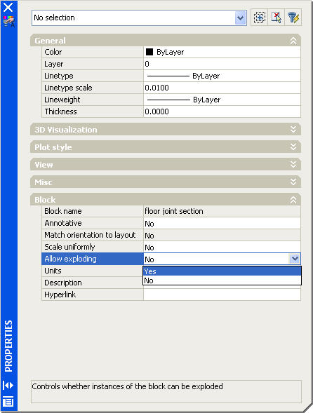

DNK Posted February 18, 2010 Posted February 18, 2010 FWIW, you can do with the BLOCK EDIT COMMAND. For the sample drawing, you have to unlock the BLOCK EDITOR. At the command line, type BLOCKEDITLOCK...enter a value of 0 (zero). Then enter BEDIT Once you are in block editor, open Properties. With nothing selected, there is a toggle to allow exploding. Quote
