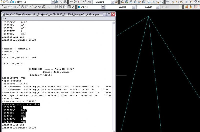

KiLLiNG-TiME Posted October 25, 2010 Posted October 25, 2010 (edited) Intresting .. the team i look after on a project have & still are having dimensions issues e.g. changing when re-opening drawing that they have been working on, all is fine before they close, but when re-opened the dims seem to just jump of into space, I have tried all the obvious to find the issue to no avail. This is the email sent to support We are experiencing issues opening AutoCAD 2010 DWGs containing Annotative Dimensions, where some annotative dimensions are arbitrarily expanding out to the extents of the DWG without user interaction. I have attached a zipped example, so if you open this and Zoom Extents you will see some dimensions that show this. Do you have any idea what could be responsible for this? This was my reply & a fat lot of good it is too !!!! This issue usually occurs if the dimension have been snapped to objects that do not support associatively or if they have been placed using the PERP osnap. The dimensions will need to be disassociated (DIMDISASSOCIATE) and re-associated (DIMREASSOCIATE). really !!! If anybody else has experanced this kind of issue any help would be most helpful & greatly appreciated. There are no overrides in the Dimension style manager ? & they are in model space & they are annotative & they are associative. I know its not strictly a scale issue but this is the closest post i could find. Edited October 25, 2010 by KiLLiNG-TiME Quote
irneb Posted October 25, 2010 Posted October 25, 2010 It does seem to be due to the perp OSnap. I had this problem way back in 2005, so AnnoScales had nothing to do with it. It got so bad that we had to DimDisasociate everything and change DimAssoc=1. It would constantly stretch dims to hell and gone each time you opened the DWG (whether they were drawn in MS, through a viewport or directly on PS). The only thing I could guess at was that they were picked using the Perp snap, since it only happened where this type of snap occurred. Maybe if you turn off the Perp OSnap you should be fine, but then how would you do DimAligned (rotate the UCS and use DimLinear instead, you must be kidding right)? Quote
KiLLiNG-TiME Posted October 25, 2010 Posted October 25, 2010 The cleint requires that that the Dims are associative! arrrggg Ok so i get the whole team of 40 to turn of Perp snaps off when dimensioning !! great they will love me for that, i can see a lot of not happy emails coming my way & a lot more request for saved ucs in the menu ..oh well could be worse couldn't it! (rotate the UCS and use DimLinear instead, you must be kidding right) yeah i wish you were but i cannot see another way around this can you ? Thanks for the advice irneb, i guess i owe mr support a small apology then ..****** but i would still like to know what objects that do not support associatively !! 2005 bloody hell this bugs not been around to long then !!! what up with autodesk no time to fix such a small issue eh Quote
bonehead411 Posted October 27, 2010 Posted October 27, 2010 Personally, I find the perp osnap a pain in the backside, and would never use it for dimensioning. I choose to keep it turned off, if I need to find a perpendicular point I'll use the shift & right click shortcut menu. But anyhoo........ From the Help files: Special Situations and Limitations You may need to use DIMREGEN to update associative dimensions after panning or zooming with a wheel mouse, after opening a drawing that was modified with an earlier release, or after opening a drawing with external references that have been modified. Although associative dimensions support most object types that you would expect to dimension, they do not support the following: Hatches 2D solids Objects with nonzero thickness Images DWF underlays When selecting objects to dimension, make sure that the objects that you select don't include a directly overlapping object that does not support associative dimensioning such as a 2D solid. Associativity is not maintained between a dimension and a block reference if the block is redefined. Associativity is not maintained between a dimension and a 3D solid if the shape of the 3D solid is modified. Quote
