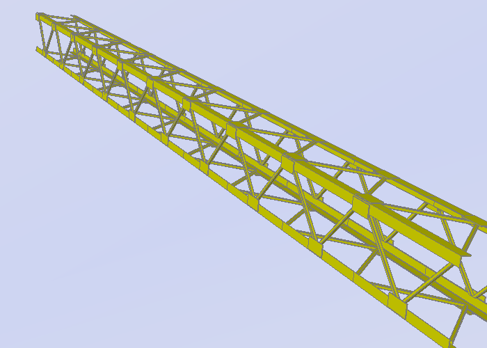

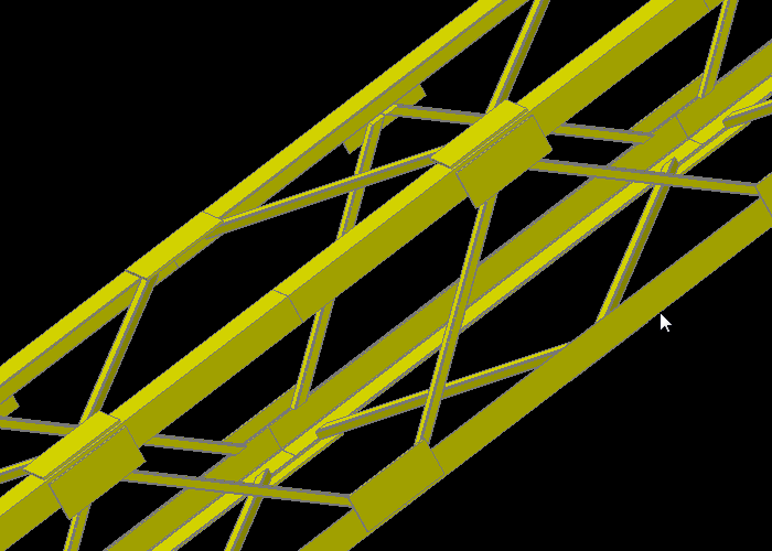

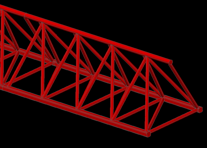

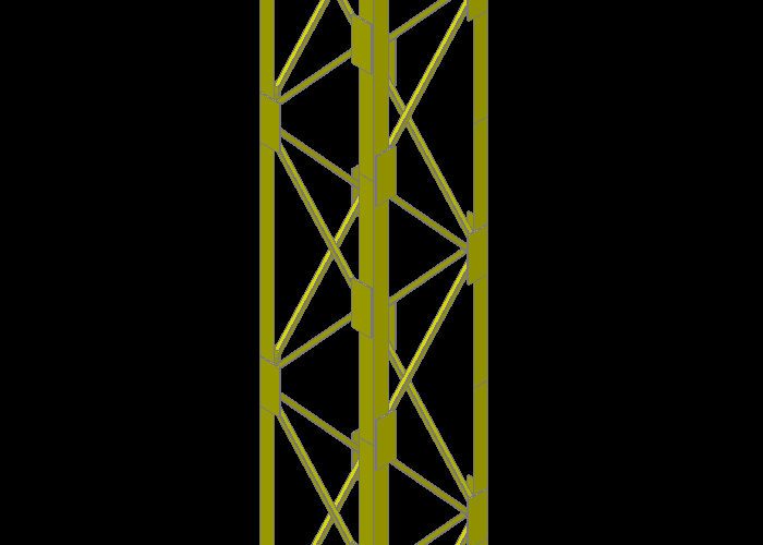

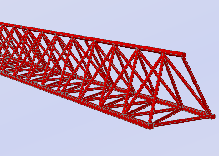

Here are some suggestions... I would say the Mast and the Jib a little complicated but if you can get that accomplished the rest will be easy.
I made the mast in eight foot sections extruding the outer frames and cross members. (I still have to add the bolts on the mount plate).
The Jib is a triangular truss with supports at different angles.
Now I have to finish it.
