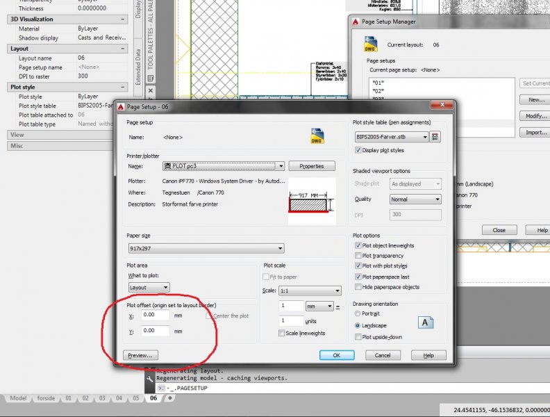

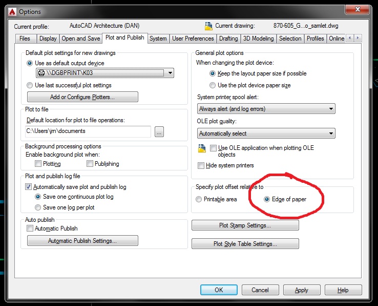

But, the one thing that I have found that messes with plotting with the Layout setting is the Plot Offset - you find this under tools > Options > Plot and Publish > Specify Plot Offset relative to:

Have you checked tools > Options > Plot and Publish > Specify Plot Offset? Try changing the setting and see what happens.

I know it's long time ago I started the thread...
Hope these screenshots may be helpfull
Best wishes :-)
