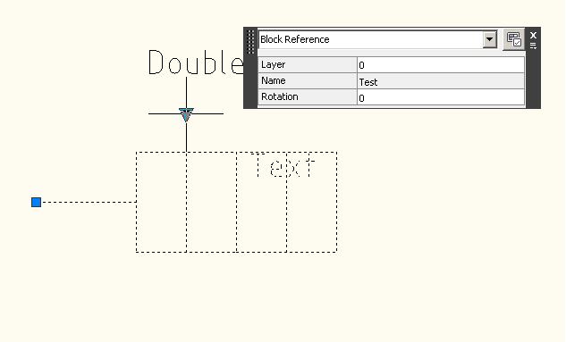

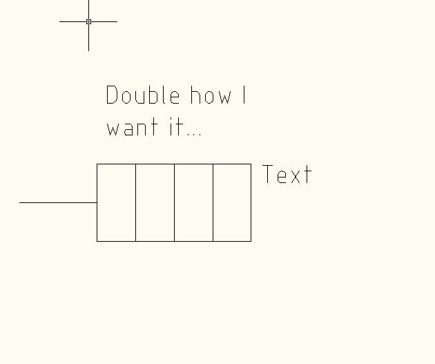

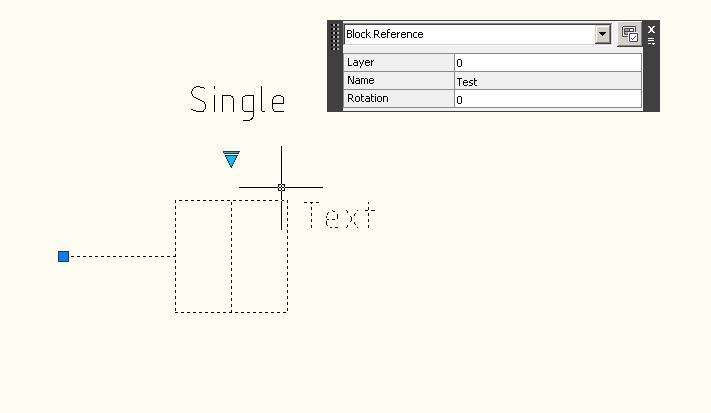

MarcoW Posted February 19, 2010 Posted February 19, 2010 Hello, I am pretty new when it comes to dynamic blocks, so be gentle. I am playing wit a dynamic block (test) wich contains 1 attribute. The block can be 2 different variants: single or double. If single, I need the attribute there where it is. If double I would like the attribute to move. Or text or any other object I want. See attachements for my goal. How to do this? Any help is appreciated. Quote
dbroada Posted February 19, 2010 Posted February 19, 2010 I'm not sure you can. I'm not sure what you are doing but what I would do (possibly) is instead of using the visibility parameter I might use a distance parameter & array action. If you do that you can add a move action to the distance while giving the distance a 2 settings list. This only works if the double is 2 single units rather than 2 different units. Quote
MarcoW Posted February 19, 2010 Author Posted February 19, 2010 Hi dbroada, I am trying to make a block that can differ in size. Not too complicated. The stretching and few other things I can do for I have found some good tutorial videos on that matter. In my case it is gonna be an attribute that gets in the way if the block gets bigger. So with the visibility change I would like the attribute to move to a new location. Hmm.. I am not sure how to do. Your approach I cannot do for it has nothing to do with array. I tried but no succes. I am shure there is an easy way but as allways.... if you do not know where to look.... Quote
dbroada Posted February 19, 2010 Posted February 19, 2010 in my way (I'm at home so no ability to create block) you give the distance 2 list possibilites, say 50 & 100. Set the array to a 50 spacing and select all the items. That way when you increase the distance all the items selected copy 50 to the right. The move action can also be triggered on the new distance. Another possibility is to look into lookup tables. Thinking back I am sure you can have visibility states and positions but I can't look in to it for you until at least Monday. Quote

dbroada Posted February 23, 2010 Posted February 23, 2010 ok, how about this..... First, despite what you may think you MUST LOCK attributes if you want to move them. I have only arrayed the semicircle and streched the base line. hope this helps. DB_Test.dwg Quote
MarcoW Posted February 23, 2010 Author Posted February 23, 2010 Dave, Tnx... I have tried to figure out what happened. So I open the properties palette: 1. I see you have loched the attribute... funny, lock it to be able to move it... 2. I see the move action is linked to the distance parameter and that only 1 object is connected with the move action: the attribute. However if I unlock it, it still moves... How come? 3. I am shure I did the same as in 2. but somehow I have missed something. One must be very careful I guess... 4. I added the align parameter, that I understand too. 5. When having visibility states, I can click on the visibility parameter and select wich of the 2 I want. In this example I must manually stretch. Is this where the lookup parameters are for? If so then I must look into that too. I appreciate you help, tnx again. Quote
