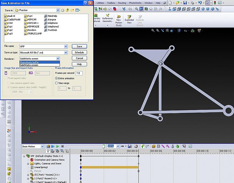

You have to do two things. Setup an animation,basicmotion or advanced motion. then you need to setup your photoworks environment, materials lights etc. When you go to save animation you will the option (shown below) for photoworks buffer. I believe the quality is going to depend on several things including what you use for your video compressor. I think Microsoft Video 1 will probably give you the lowest quality

If you do an exploded view It will show up in your configurations. You can right click on the configuration and animate the explosion or collapse. You will have the same Rendere options for photoworks. Cinepak seems to do a pretty good job.

no problem ray. SW does an excellent job if you spend some time playing around with it. If you create a camera(insert> lights and cameras) you can get some realistic shots. Also creating a scene in photoworks, playing with lights and materials and so on can go a long way. Just today actually i did an exploded animation of an assembly thats going out for bid. I wish i could post it but its too long and somewhat proprietary:)
